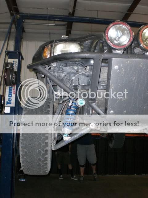

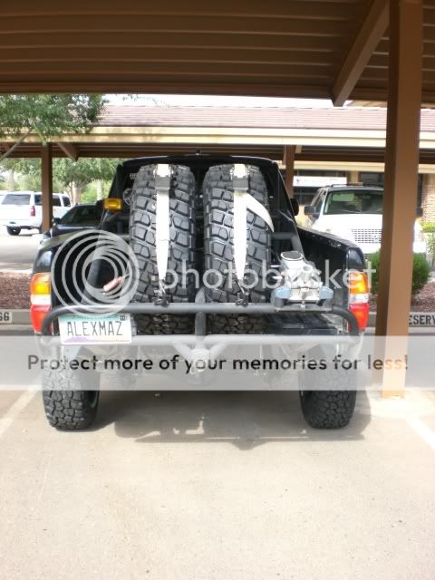

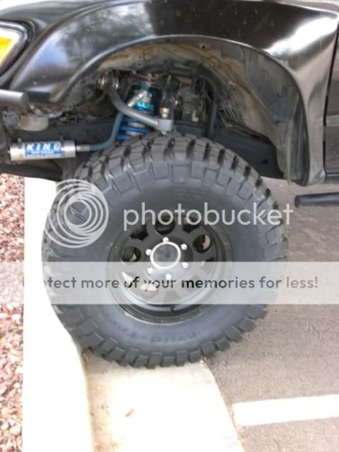

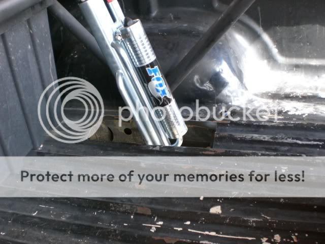

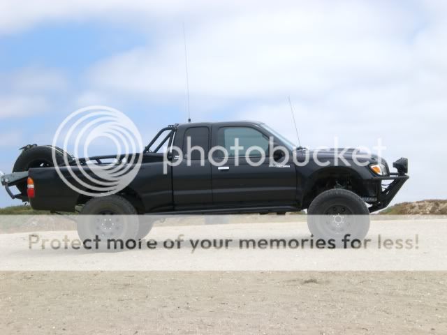

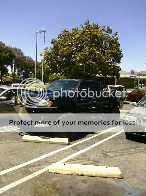

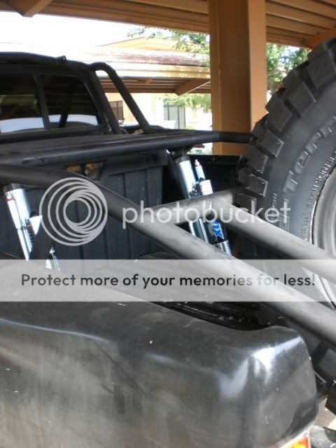

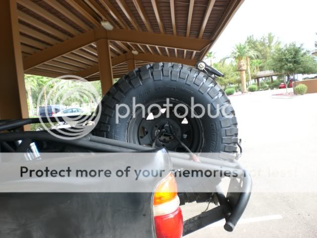

Alex's Long Travel Build
Specs:
Chassis
2000 Toyota Tacoma Xtra-Cab 4x4 V6
01-04 Tacoma front end conversion
Engine
3.4 liter V6 (5VZ-FE)
TRD 2nd gen Supercharger
URD 2.2 supergrip pulley
URD 6 injector fuel/timing upgrade(piggyback) with pump (Street tune by Gadget @ URD)
TRD headers
TRD muffler
Generic intake with prefilter
Exterior
Front glassworks unlimited fiberglass 4.5" flare fenders
Rear glassworks unlimited fiberglass 6.5" flare bedsides
Glassworks unlimited fiberglass scooped hood
1.75" DOM front tube bumper and aluminum skid plate with (3) 7" HID lights
Demello Rock sliders
Tuffbox lockable cargo box bolted down inside the bed
Roof/bed cage light bar Fully adjustable all on 1/2" heim joints
Cup holder Bed Sides
Fold Down light rack with (5) Spot beam HIDs
Interior/electronics
Pop up moonroof
Powerbass amp
Crimestopper paging alarm
Alpine S-Type Speakers
Kenwood Deck
Front Suspension
Total Chaos uniball long travel bumped and strapped 13" travel
Total Chaos heim joint steering upgrade
Total Chaos spindle gusset
Total Chaos secondary shock hoop
King 2.5x8 Coilovers with 600# Springs
Tundra axles
Rear Suspension (bumped and strapped 17" travel)
Bed Caged all DOM and Tig welded
62" Deaver custom race F-67 long travel leaf springs
Total Chaos 12" chromoly shackles
Total Chaos front spring hangers and rear shackle pivots
Total Chaos U-bolt relocation plates
Fox Pro Series 2.5x18 Triple Bypasses
TRD rear end with electronic locker (4.10 gears)
Wheels/Tires
(4) 15” KMC Enduros
(4) 32x11.5-15 BFG Km2s
Extras/Spares
(2) 15x8 steel spares with 332x11.5-15 BFG Km2s
Aluminum Jack with skidplate
Future/Ordered mods (No special order)
Total Chaos Coil Bucket gussets
Front triple bypasses
Co2 Tank setup
Fully Box in Frame
Engine Cage
Mastercarft or Corbeau Suspension seats
5 Point Harnesses
Rear Axle Gusset
Redo interior to match new seats
Maybe Ford 9" rear Not sure yet.
lowrance HDS-5 Baja Off-Road GPS Chartplotter
2m Radio
Pictures

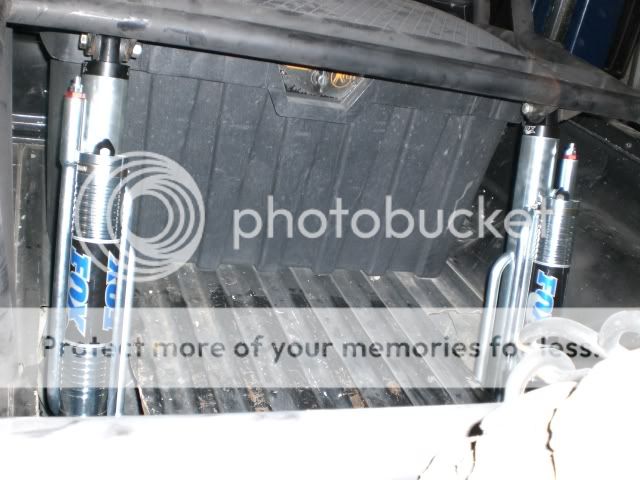

Thanks guys. So far the only thing I've added were the rear bypasses. I need to go out and tune them in now

Quote:
Originally Posted by BLACKHAWK250 View Post
Nice man! How much travel u getting out back? Strapped at like 18"s? Curious cuz ur running 2.5"x18" out back
Its strapped at 17" I can adjust it to get a little more. Without the straps it pulls 18".

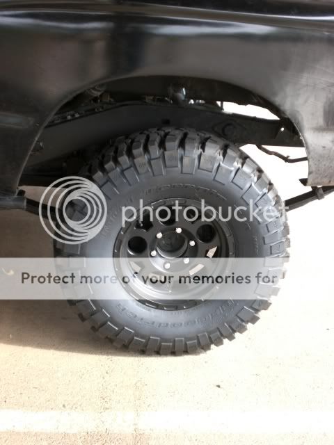

So my wheels and Tires should be here this weekend or early Next week.
6 - BFG KM2s
