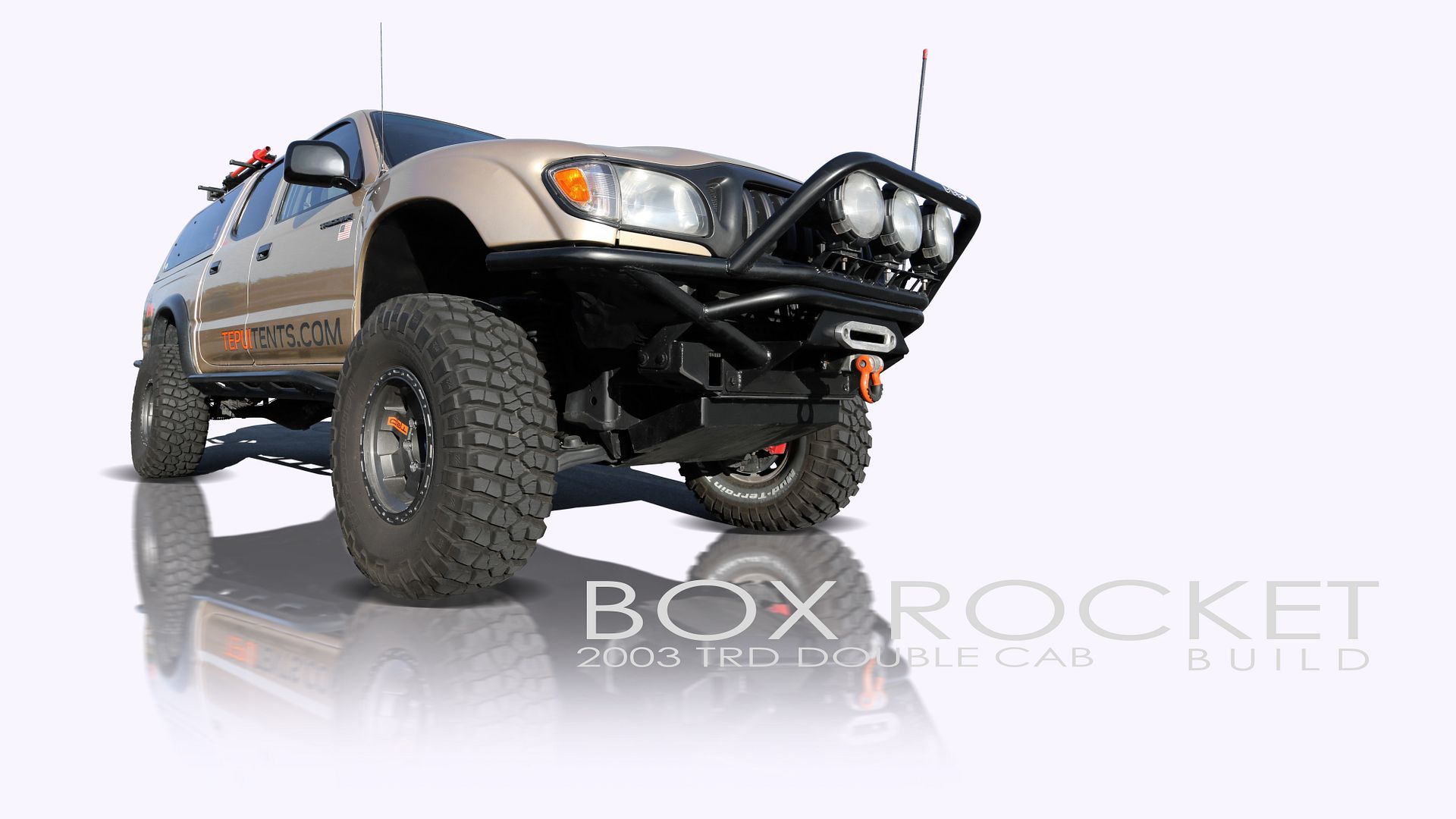

Box Rocket - 2003 TRD Doublecab
I picked up this 2003 DC in Feb of 2010. Wanted one for a long time and wanted to get back into a 'minitruck' since I'd had a couple older Toyotas in the past. I've mainly been a Land Cruiser guy but I had an '85 and a '93 SAS pickup too and I loved both of those trucks but needed more seating so the DC Tacoma seemed like a great option.

But back to the beginning.....
Here it is when I got it. 2" spacer lift and 32's.
I was planning on using it as soon as I could so the first order of business was some sliders. I got a set of TrailGear sliders and got them welded up in my garage and installed.
Sliders all finished up.
