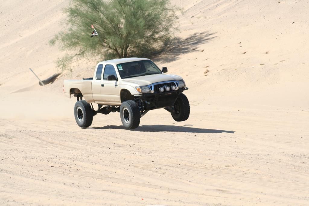

“When I was 5 years old, my mother always told me that happiness was the key to life. When I went to school, they asked me what I wanted to be when I grew up. I wrote down ‘happy’. They told me I didn’t understand the assignment, and I told them they didn’t understand life.”
— John Lennon
2002 Toyota Tacoma Prerunner V6 SR5
Front:
Camburg Long Travel
King 2.5 x 8" shocks with a compressed length of 14 3/8"
King 2.5 x 8" bypass shocks
Fox 2.0 x 2.5" bumps
TC spindle gussets
Glassworks front fenders
13.5" travel
Wheels/tires:
Ion Alloy 16x8 174 wheels
BFG A/T 285/75/16
Rear:
Deaver H70 SUA w/ 12" shackles mounted 52.5" hanger to hanger
King 2.5 x 16" bypass shocks
Built Right u-bolt plates
Hanneman bedsides
17" travel
Misc
Twisted Stitch Pro seats
Crow 5 point harnesses
Poly steering rack bushings
Willwood rear BPV
LCE solid engine mount
My fab parts
UCA gussets
Alignment cam/LCA gussets
Outer rear frame plates
Inner rear frame box plates
Motor mount perch gussets
Solid transmission mount
Rear shackles
Front spring hangers
Lower rear shock mounts
Front bumper/skid plates
Full roll cage, engine cage, bed cage, tied front to rear 1.75" DOM
From day one
