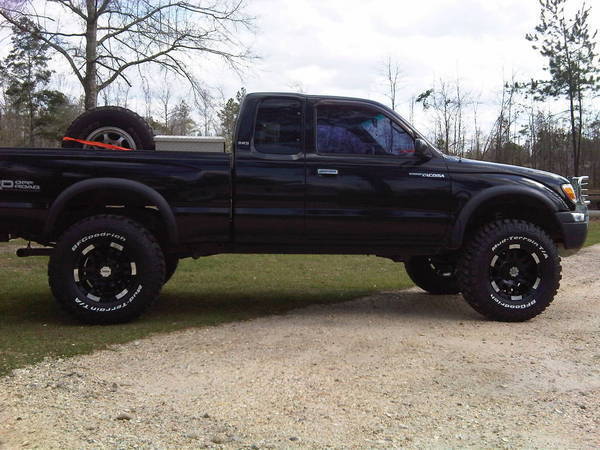

    This is my 1999 Toyota Tacoma PreRunner. 3.4L V6 with 230k miles. This is how she sat as of 10/1/11
    This is how she sits as of 10/2/11

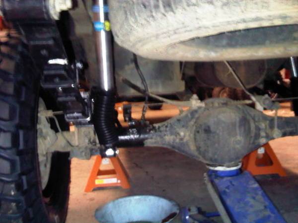

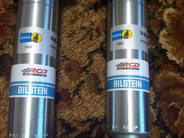

    This is how it went:

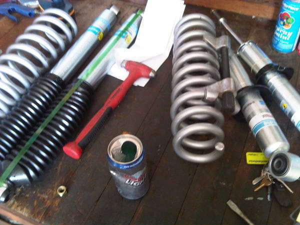

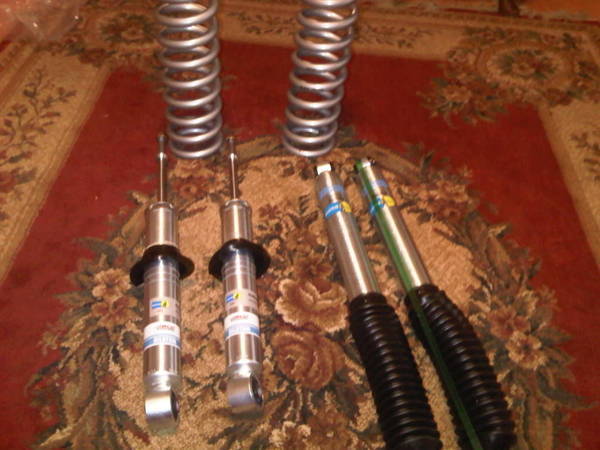

    I ordered some Bilstein 5100s and 5125s and Eibach coils

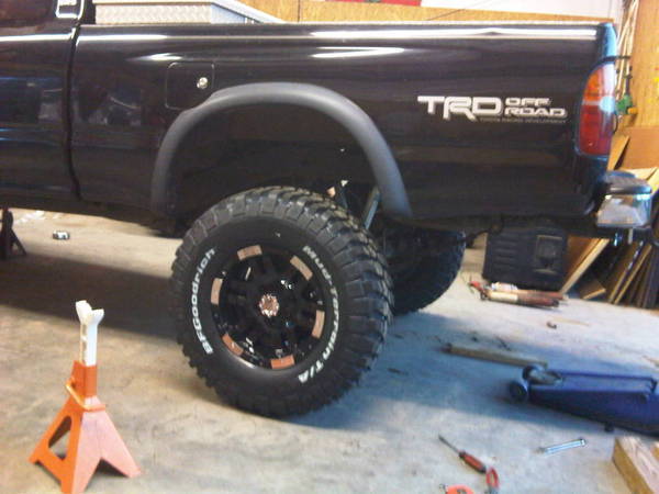

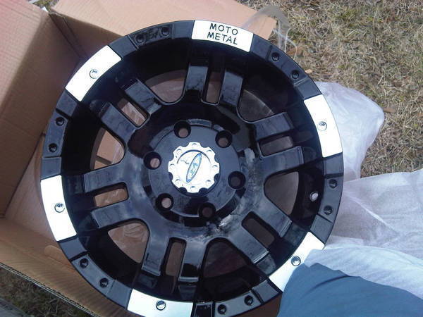

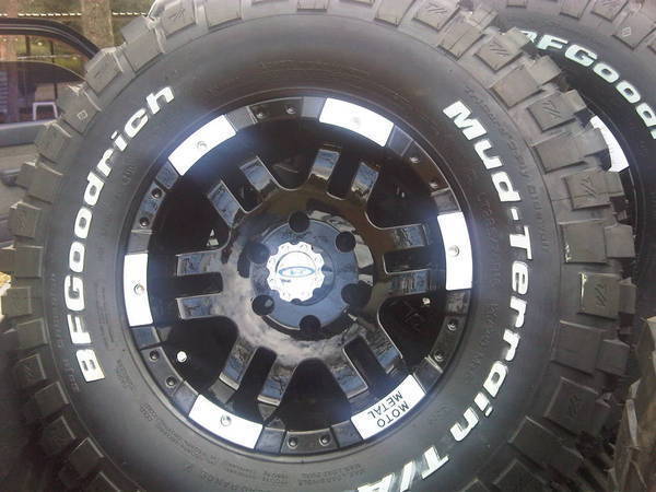

    Got new tires and wheels
    285/75/16 BFG KM2 with 16x8 Moto Metal 951 in black

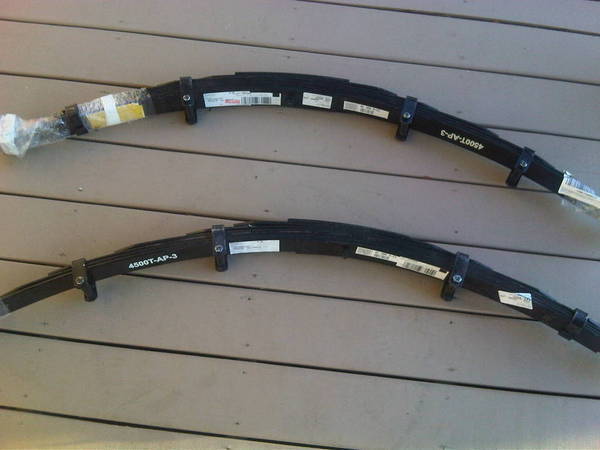

    All Pro Off-Road leaf springs

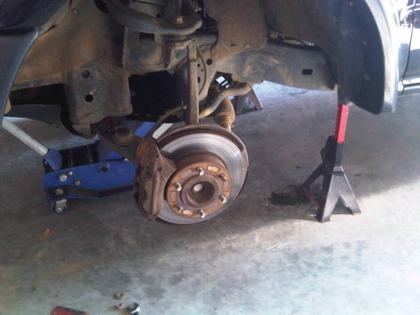

    Strut and coil removed

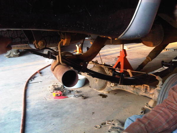

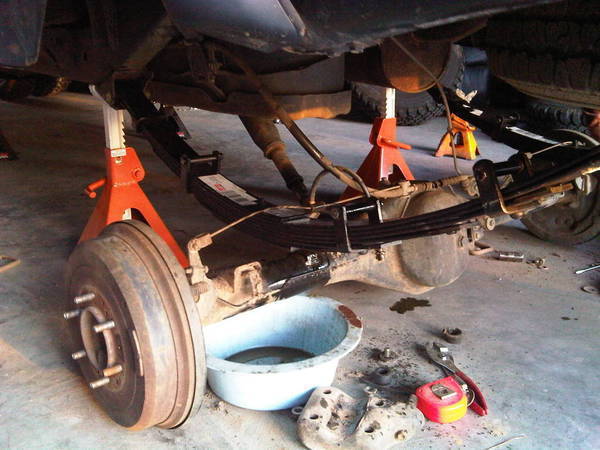

    Installing the leaf springs

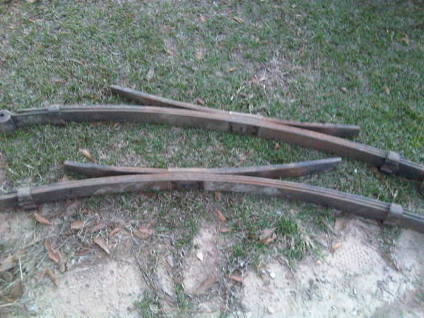

    The old leaf springs

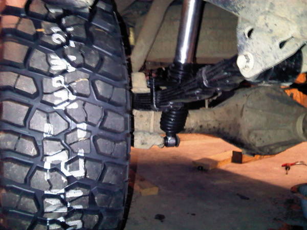

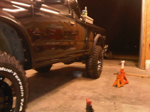

    Fresh off the jack stands

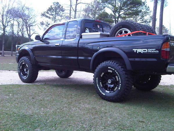

    AFTER SHOTS

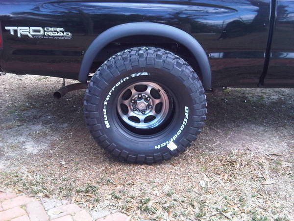

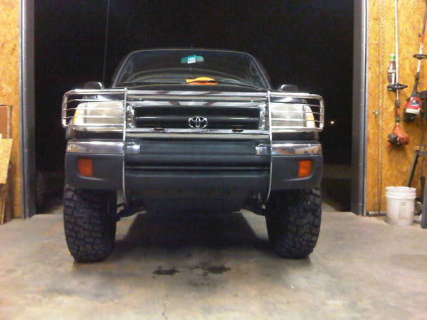

    So here is BEFORE and AFTER. Which looks better?
    BEFORE
    AFTER

    Looks good man how was the leaf replacement i had to cut off the front leaf bolts and beat the shackle bolts out with a sledge hammer.

    Thank y'all, I'm in love all over again :D
    JLee: It went a whole lot easier than I was planning, they bolted up with no problems besides having to disconnect the break hose (no biggy)

    Yeah the bolting up wasn't my problem it was taking off the stock ones. So you didn't get the extended brake lines?

    They came off as easy as they went on... :eek: No not yet, I couldn't find any around here (didn't really look hard). I'm going to order them today or tomorrow. And I used the factory U-bolts, I bought some longer ones from AutoZone, but my stock ones fit so I returned them.

    Yeah i would get those break lines ASAP you could really do some damage to your hard brake lines just going over a speed bump.

    well we adjusted it to were it should be good until I get my lines in... hopefully

    Sweet truck! How does your truck ride with those shocks and coils?

    It's a little stiffer than I thought it would be, but on the road, it feels really good. I haven't got to take it off road, seeing how I just put the lift on 2 days go. I love how the leaf springs ride!

    Yea, you can install yourself. You don't have to replace ALL your brake lines. Just the back one. It's nothing to it.

    Sick! Where did you purchase the 5100s?

    The were a little stiff at first but have gotten smoother. Rides real good on the street. I haven't tested them off road yet.

    I got the 5100s and 5125s from Down South Motorsports

    What size are your mud terrains? I am going to put a 6" lift on my Tacoma and am debating between mud terrains and all terrains.

    Hey man did you get the regular 3" all pro leafs? or the expedition leafs? if they're the regular, how well do they hold up to a lot of weight? does it squat a bunch?

    My tires are 285/75/16... but if your adding 6", go with bigger tires than what I have.. definitely get mud terrian! lol
