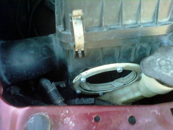

First thing I did was the deck plate mod. Cost all of about $10 total and 10 minutes of my time.

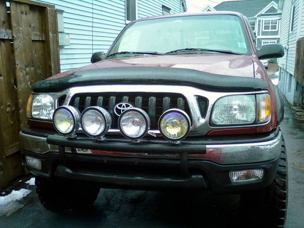

The next thing I did was a light bar from Snobord:

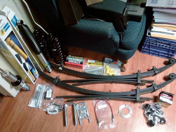

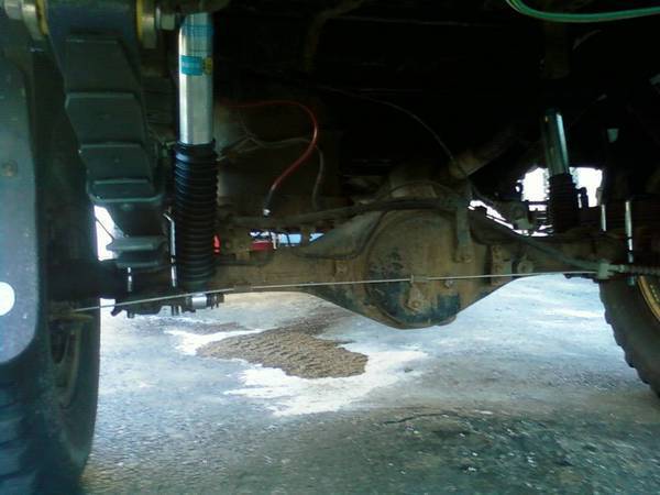

Then came the good stuff. I got a full suspension set up. I went with Bilstein 5100s up front at the 2nd notch and OME 881 coils. In the rear I went with OME Dakar leafs and Bilstein 5125s. Plus a bunch of other little odds and ends.

Rear installed
