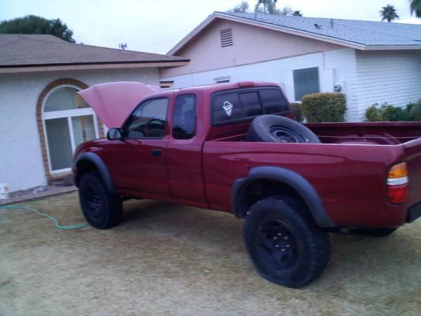

I've had my truck for just over a year now, and recently I decided
to commit to the project of converting it 4x4.
What I've done so far
  • Falken Rocky mts 265/75/r16
  • OME coilovers
  • Rear 5100's
  • Home made Rear Bumper
  • Home made Spare carrier
  • Debadged
  • Recessed Grill
  • Color matched lower valance
  • Painted wheels black
  • Red Guage lights
  • New radio
  • Flowmaster 40
  • Exhaust cut before axle
  • Deckplate
  • K&N filter
  • Swapped output shafts
(thanks Brian)
