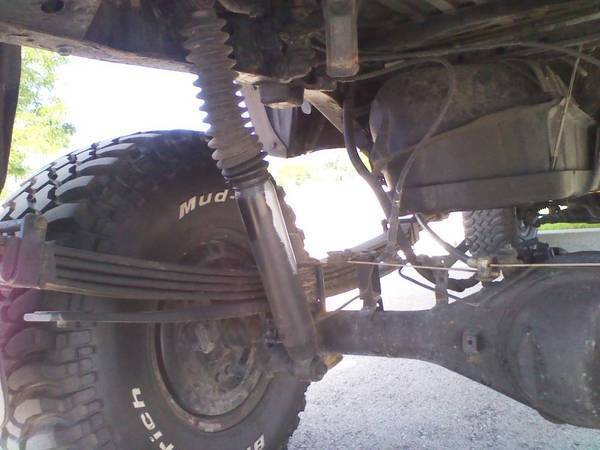

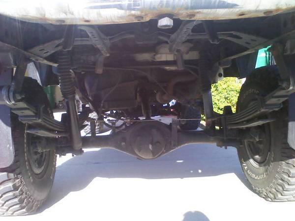

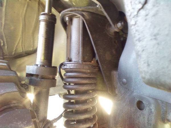

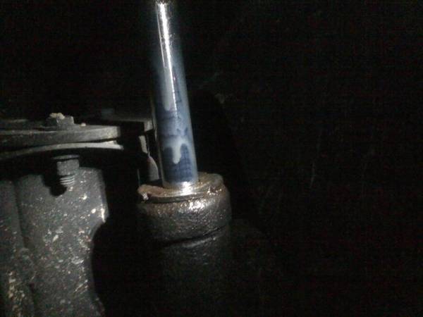

Suspension pics...
lift struts had rubber boots on them which had electrical tape on them...
Cut the boots off, wire brushed the rust/corrosion underneath, then gave them a coat of Rustoleum enamel, should have used FLAT instead of Gloss black, oh well...
They turned out looking okay, gave everything a bath in white lithium spray grease
View from the rear

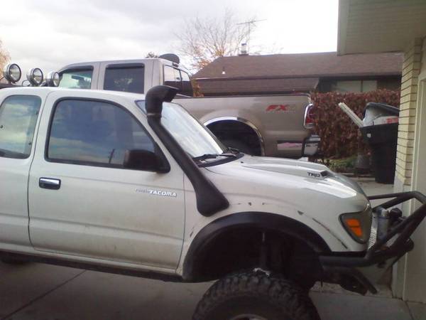

Added Roll bar with lights $175 and most of saturday to clean it up, redo lights, wiring etc...
Safari Snorkel $Free took about 2-3 hours of work

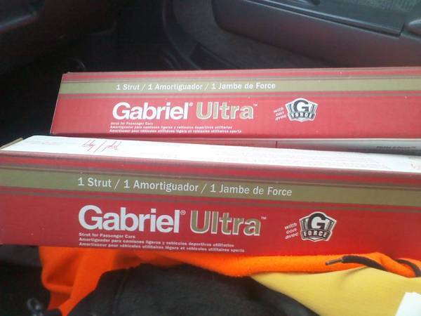

Went wheeling and blew my secondary strut on my Trailmaster lift.
Installed my new ebay headlights and sidemarkers I got for Christmas
Did some research on fixing the POS Trailmaster lift, looked into the Gabriel Inversion Mod since Trailmaster no longer makes the struts
after checking out my lift closer, the Mod has already been done so It's as easy as replacing the struts
Bought my new struts, I'll go the cheap route for now and see how long they last, next set may be Billies!

Replaced the struts on my Trailmaster Lift and did the "grey wire mod" for my locker now that i know it works. Also fixed a grounding issue i had with my KC Lights on the bumper

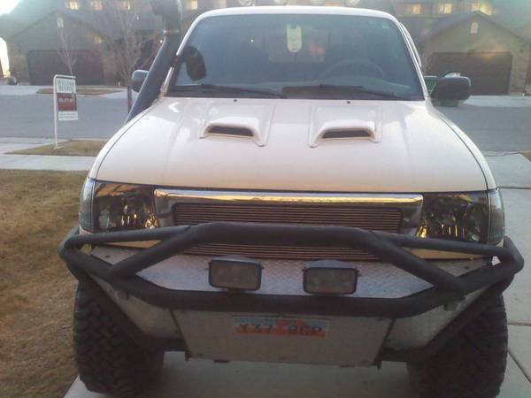

Remove the body lift would be a great start. You can still easily clear those 33's even with the body lift off.
If you don't want to drop the money on new tail lights just yet, you can always lightly tint those to "mild" down on the rice.

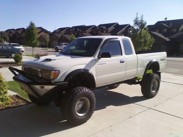

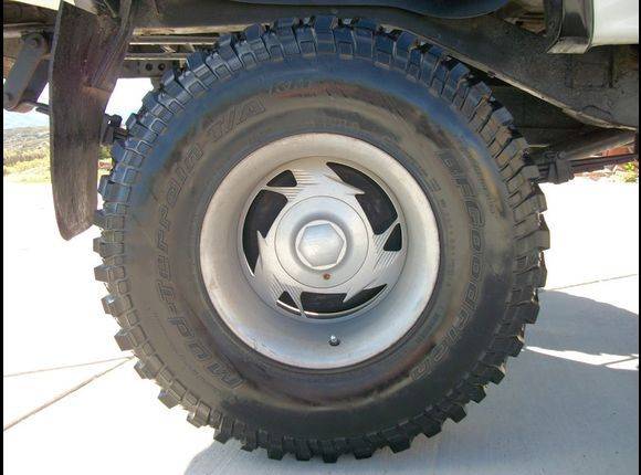

Added more pics... I want to fit 35's when the 33's are dead, can i do that without the body lift?

I say take off the hood scoops (if they're attached), new rims, and take out the diamondplate inserts on the bumper...I think the bumper would look pretty good without them.
I'm pretty sure you can, a friend of mine does.
