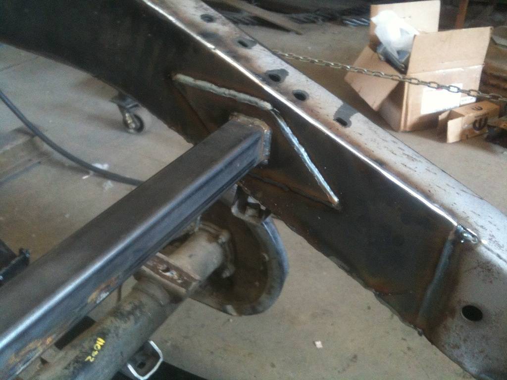

So I sandblasted it and started welding. Gussets, crossmembers and then some gussets.
Cam tab gussets.
Rear outside plate.
Coilbucket gussets.

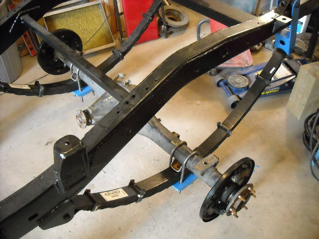

Boxed rear frame and crossmembers.
Painted the frame.

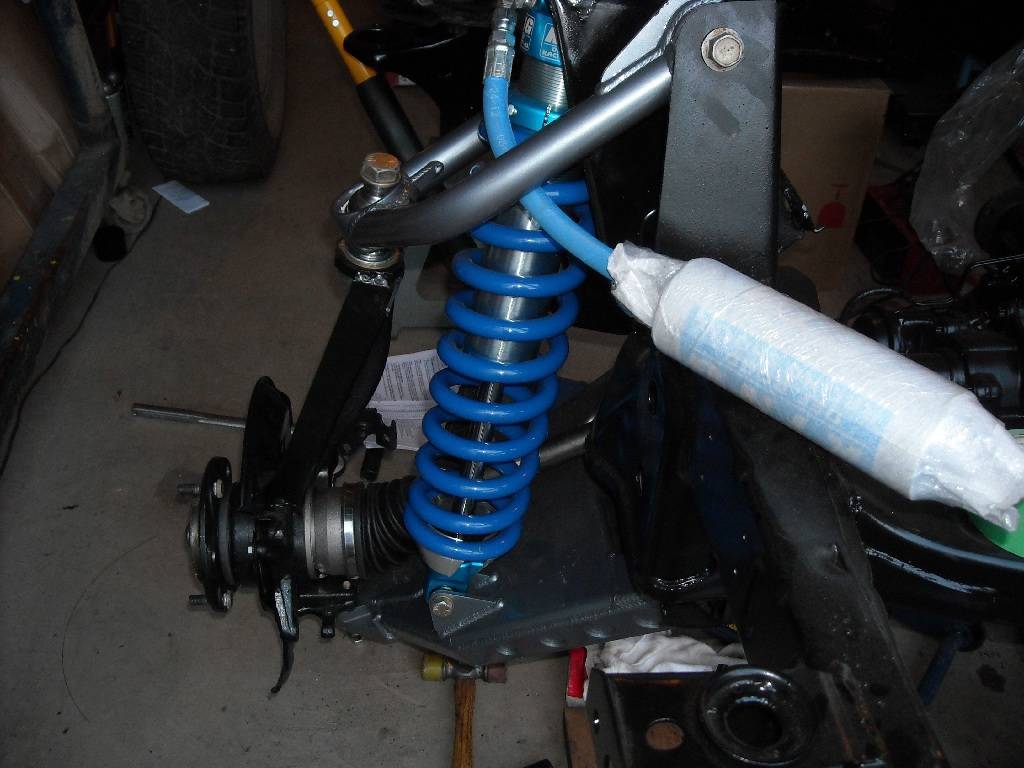

Assembling suspension.

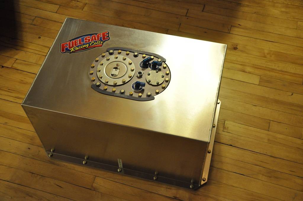

My fuel tank was rusted to a flaky blob around the plates, and attempts to clean it resulted in chunks coming off.
So I decided a new stock tank was too expensive for just a stock tank, and used tanks in my area would have the same issues as mine.
So I ordered a 22 gal. Fuelsafe cell.

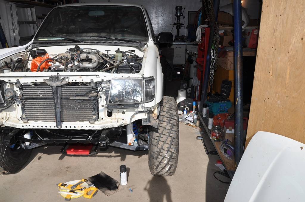

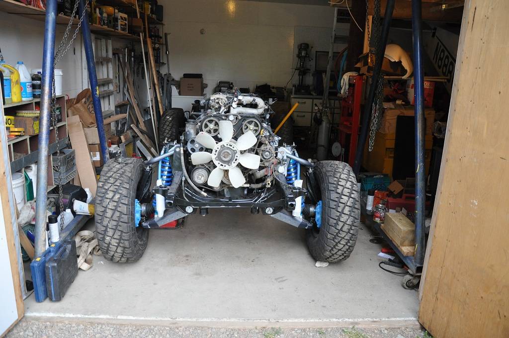

Meanwhile, things progressed on the truck. Got the engine and cab back on.
How much the wheel sticks out over stock.

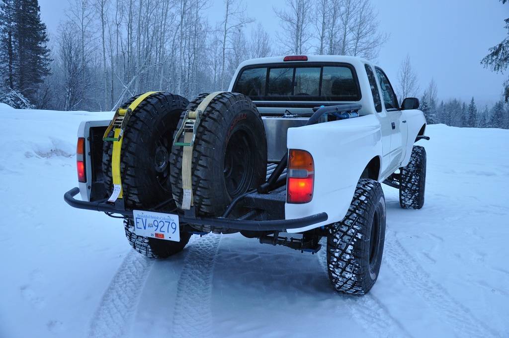

Front and rear bumpers were next.
Attached the fiberglass and that's how it was until May.

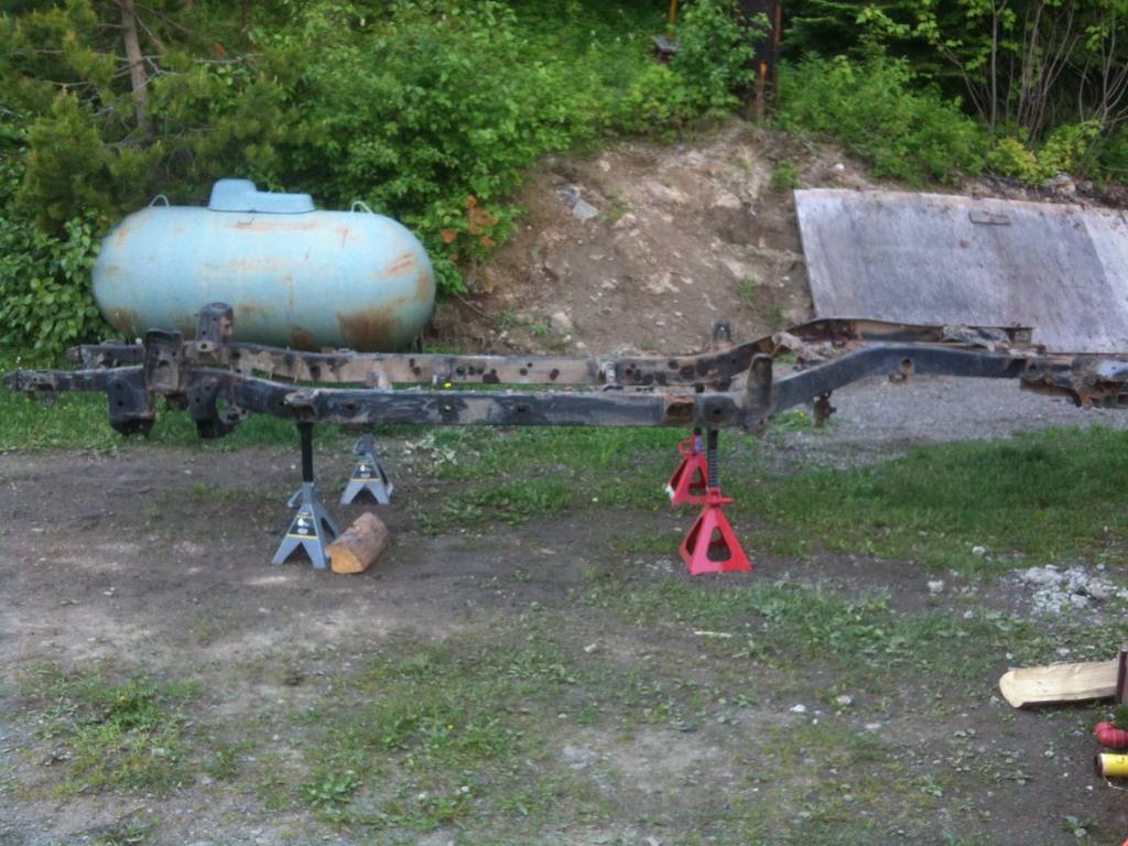

I pulled everything off my frame and am starting from there because there are some rusty parts, so I figured I may as well go through and replace/refinish everything that is rusty.
I have the TC coil bucket gussets, cam tab gussets and am making rear frame gussets. I want to weld on everything I need before I re-coat my frame so that I don't have to grind off my new finish.
If anyone thinks of anything I should be welding onto my frame let me know. Maybe limit strap tabs?

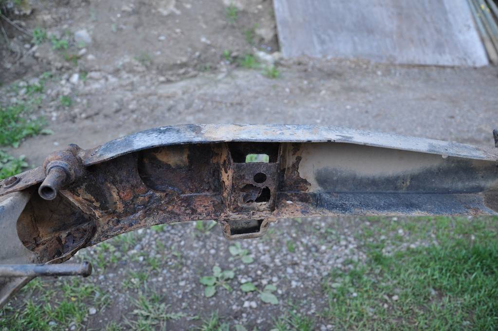

Heres some pics of the rust.
Its mostly in the rear C channel. The frame is still solid but I stuck my finger through these parts.
So I have some work to do

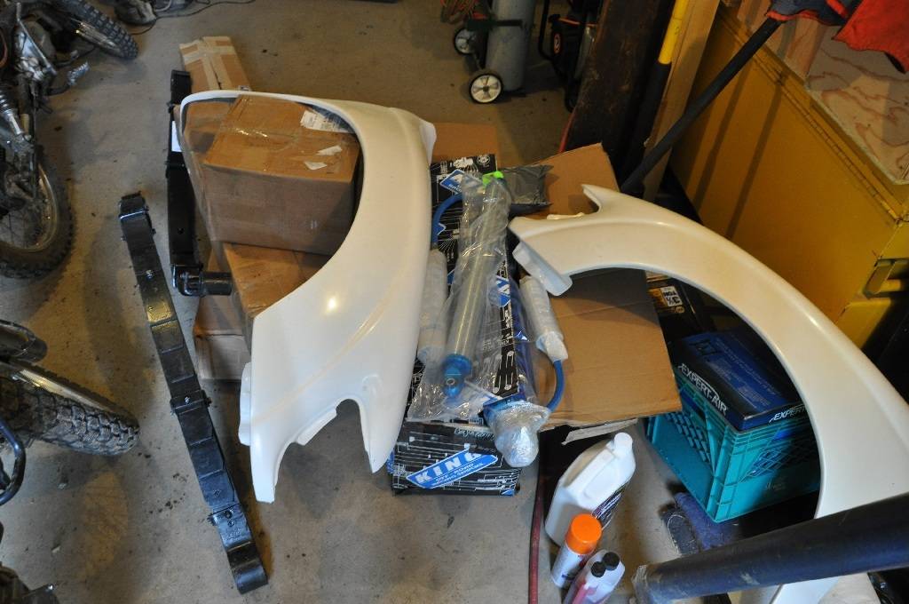

Quote:
Originally Posted by whitetoblack View Post
Hey man nice job i like where this is going haha. Since your are upgrading to a tundra axle anyway as well as wanting to run wanting to run 18s have you thought about just going with giants 64" kit instead and mounting it outside the frame rails? I have two friends running them on their rangers and they work really well just havent seen one in person on a taco yet.
Never thought of that, a little late now...
got a very nice shipment yesterday^

So I finally made some decent progress on my frame.
I only have cellphone pics, but I'll take some decent ones later when the frame comes home.
boxed
rear gussets
cam tabs
coil bucket gussets
also sandblasted frame is really nice^
and leaf mounts (big thanks to battlescars and cr1250jumper for all the advice and helpful pics)
So I just need to put some new cross members in the rear and I can paint and put things back together.
