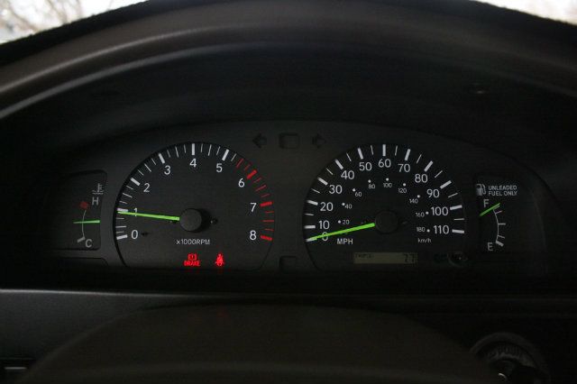

When you did the gauge cluster lights and needle mods, did you take the needles off or just paint them when they were on the gauge?
If you took them off, was it a pain in the ass to get them back on so that they were calibrated?

Thanks boss! Yes, I took all the needles off and scraped the orange off the backs and repainted with Walmart paint markers. The calibrating wasn't TOO bad but it was a little bit of a pain. Must have time and patience. Took me quite a bit of driving around and comparing speeds with a GPS to finally get it. Right now, I'm barely 1 mph off.
