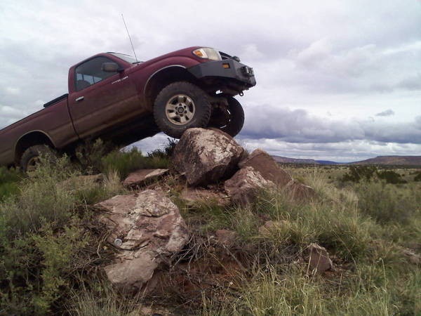

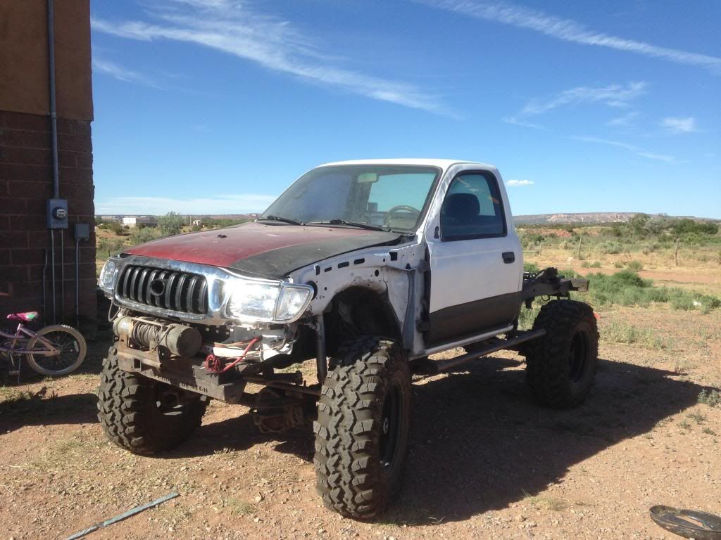

As it sits now...

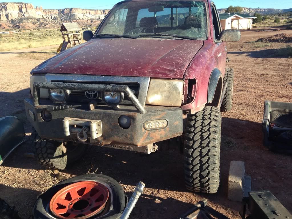

What it used to look like before the roll in Moab '14

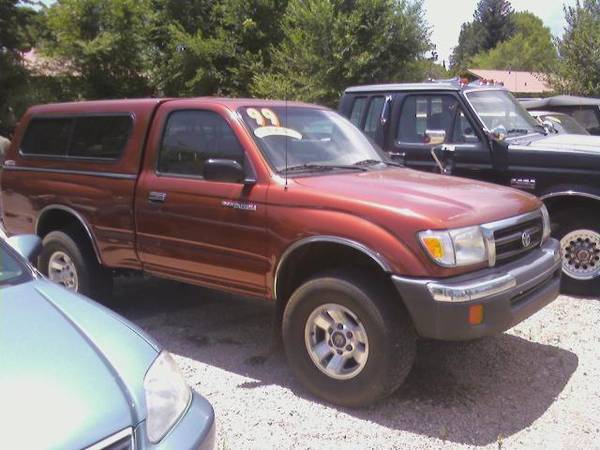

Life for my truck started out as a stock single cab that I bought used with about 86000 miles.
It came with some all-season tires that were low on tread but still had some life to em.

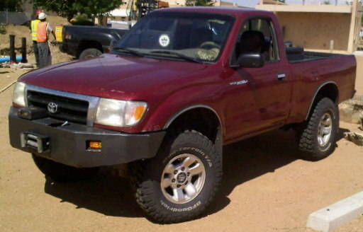

The first thing on the list was some new tires. So I waited until the ďnewĒ BFG KM2s came out with a 31x10.5R15.
I played stock for a while then I put a cherry bomb glass pack muffler that used to be on my YJ project for a while, so the insides were broken in so it didnít sound too crappy. No pics use your imagination.
After the exhaust I decided to build myself a front bumper. I didn't take photos of the build of the bumper but through the pics you can see the modifications to the bumper. The bumper was built with metal I had laying around my house. Inside the bumper sits a Smittybilt XRC8 and for turn signals I put some LED marker lights.

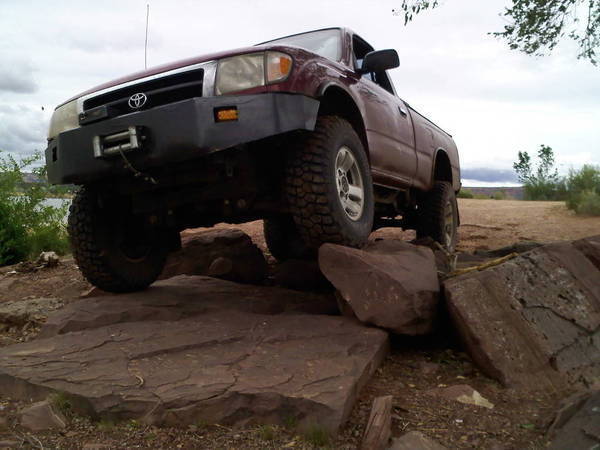

After the bumper I decided that a lift would be in order, so I could fit bigger meats on my truck. So being on a budget that I was I opted to get a spacer lift with an AAL which gave my 3 inches of lift and a slightly stiffer ride. With the lift being stiffer there was less body roll while cornering. With the lift my 31s seemed to be a little small. So I sold some cattle and bought some Mickey Thompson MTZs in a 33x12.5R15 and had them mounted on a set of Pro Comp steel 15x8 'rock crawler' wheels with 3.75" BS. Still with stock gears.
Now that my truck was a little bit higher, the wife wanted something so she could get in and out easier. So her brother-in-law who had a 4Runner had some side steps he wanted to get rid of. I took em home and cut them down to size to make em fit on my truck.
I used my truck as a truck so I didn't mind the stiffer suspension.

Teaser
Just a little update on the SAS.
Waggy D44 just needs a few more things.
Forgot to mention it already has 4.88s
