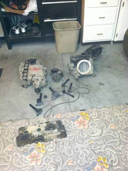

doing a top engine soak now...with some stuff, idk what it is but my tech said "its the shit"
so here the cam shaft we pulled out.

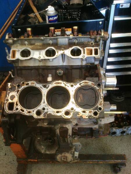

after an engine soak. cleaned all the carbon off.

i did this in about 2 hours, i broke the heads down to their components. valves, springs, retainers and keepers all out. it didnt take very long at all, it will take a ton more patiance to get them back together.
these were taken apart using a 8" C clamp and a 17mm socket, i will cut the side out of the socket to put them back in when i get the heads decked and lap the valves.
