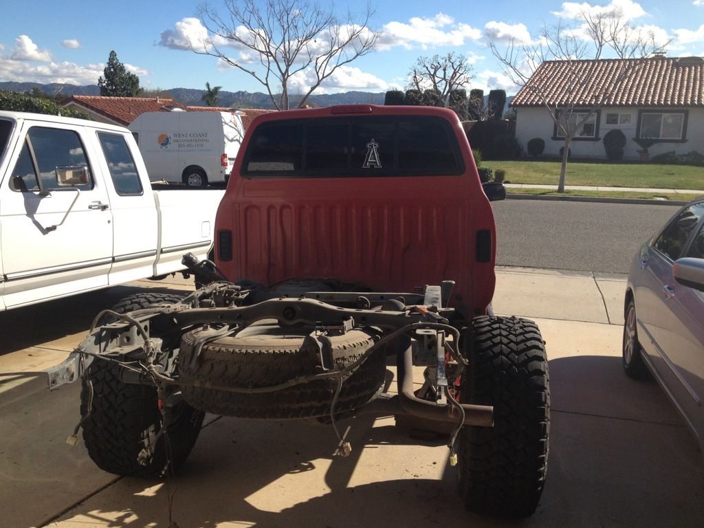

Well, had some goodies come in! OME Dakar Springs, Along with Greasable shackles, 2.0 12 inch fox shocks, and a Ubolt flip and BPV relocation bracket from Toytec. The plan is to relocate the mounts to accomodate the longer shocks.
BPV relocation
Shackles
Springs
New UBolts, flipped
Rear crossbar, which has now been replaced and welded on much stronger
Top shock mounts
Bottom shock mounts

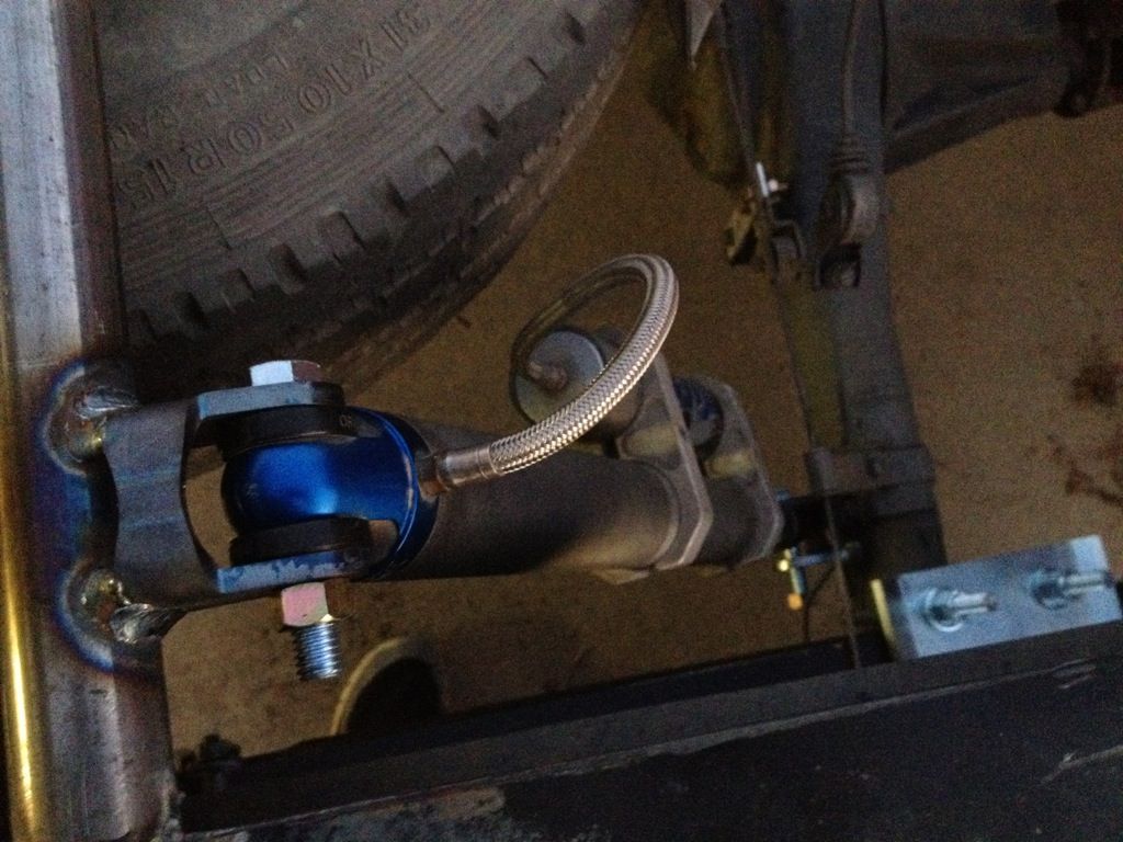

Well, the 12 inch shocks left me without an inch of uptravel. I switched to a pair of 10 inch FOA shocks, which are a much better fit. I am in the process of revalving them to my needs.

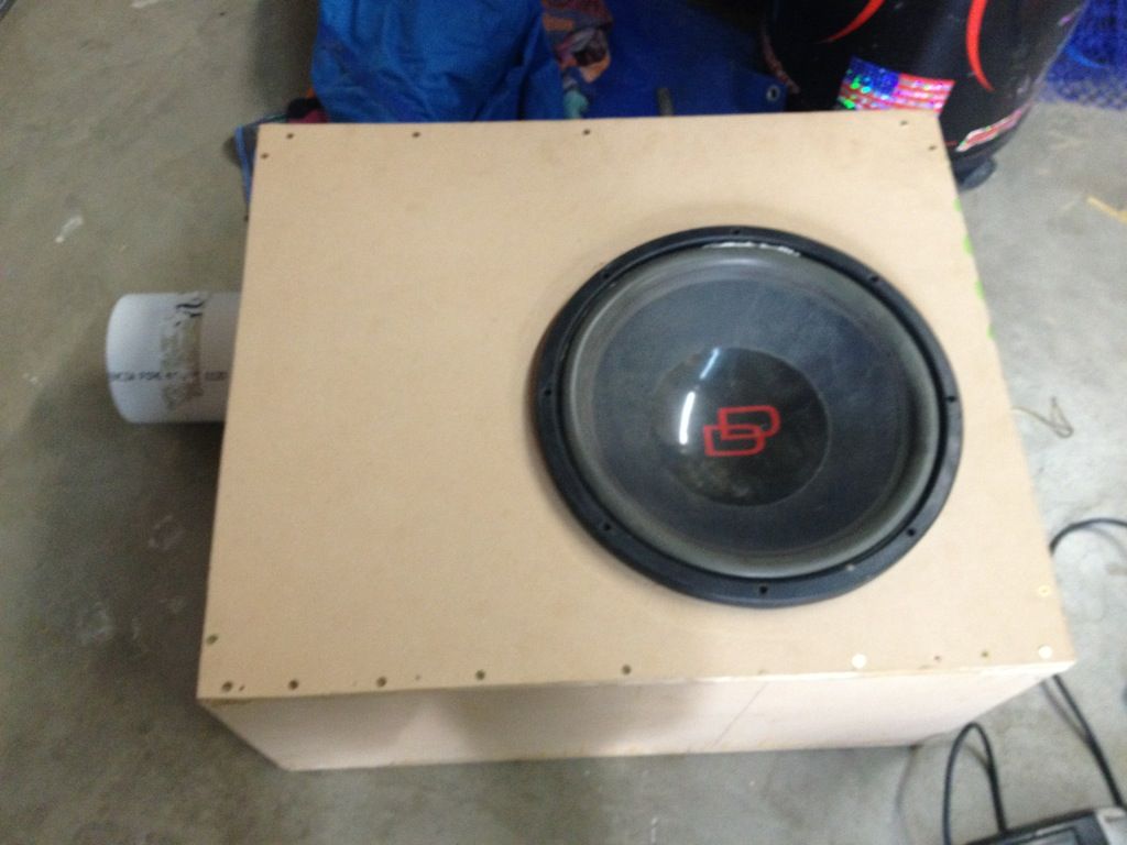

New sub, DD9515. Scored it for 60 bucks at a swap meet. There goes my back seat.

Got the rear shock mounts rewelded and painted.
