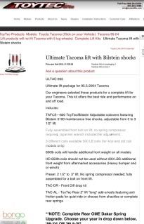

Would this suspension be great for this
Also what kind of tires would fit perfect?

No. Look int mid travel.
You'll need extended travel coil overs by either icon, fox, or king preferably with remote resivoirs and some new UCAs.
Then you'll need a nice flesh leaf pack and some nice smooth body shocks around 10-12" travel and possibly a small shock cage.
Or go big and get full long travel. Which you'll have to look up.
Btw this isn't the right place t ask this question...
