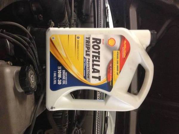

It's been quite a while since I've posted anything.. I've been trying to concentrate on getting my truck finished more than trying to show it off.
Good News: I got it started for the first time!
Question: What RPM should your 1999 2.7l 5speed idle at? Mine is currently at about 1.5k and it sounds a little too wound up
Thanks!
Rotella detergent to clean out my rebuilt engine. Only going to run that through for a very short time.
