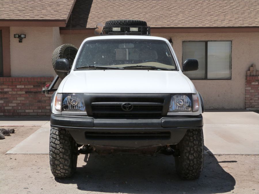

    You got anymore pics of your roof top fuel tank set up? I've thought of doing that with my boat fuel tank too

    Here's a few older pics.
    This is the 9 gallon tank. I painted it white because a big red tank up there would look silly. Of course a few years after I created this set-up, they started selling those red modular/stackable gas cans that people put on their racks. At least mine's white and I can refuel without taking it down :cool:
    I made a little custom fitted hinged bracket to secure the tank, it attaches to the non-hinged end with a large wingnut. Very secure.
    This is me airing and fueling myself during a trip in New Mexico. I jumbled together some hose, a primer bulb, and a connector to the tank. It takes about a minute to set up and prime it and once it starts flowing it takes about 6-8 minutes to drain 9 gallons. When I need to put gas in the "fuel cell" as I call it, I just stand on the tailgate :rolleyes:
    This was about 500% cheaper and easier than doing a "real" aux fuel tank, and since my truck is beat up and nothing to look at anyway, it just fits the hard-nosed motif :D

    Well now that I have a roof rack on order I may just go this route. I was going to get some rotopax but I already have one of these fuel tanks and might as well use it. What did they use as a spout on the end

    You have a pretty clean build and those expo style fuel cans are nice. I consider my set-up a little rough around the edges which kind of suits my vehicle... but if you can get your to look nice with your rig, go for it.
    Not 100% on your question, the withdrawal assembly is a plastic female 1/4 threaded elbow... pretty standard on boat tanks.

    Ya I had to get rid of the military style fuel cans when I transferred up here to kodiak.....stupid shipping company. They wouldn't let me send them with the truck cause they had had fuel in them at one time. Even though inlet them open vent for a week, they said no. I argued with them saying that, the fuel tank in the truck had a 1/4 tank and vents and that these two tanks with no fuel in them should be fine. But they didn't care.....assholes. Thanks man I've tried to keep it pretty clean so far.
    And sorry let me re-phrase my question. What do you use as a nozzle or spout at the end of the hose going into the filler cap to the trucks fuel tank? I have all the other pieces from my boat tank already but the end of my hose that connects to the engine has a connector to attach to a boat motor.

    I used to have a neat connector/adapter that was similar but just hardware, all I had to do was screw it in and push a hose on it. That was lost on a trip some years back so now I use my extra outtake nozzle with hose attached and pop it in when refueling.
    I'd imagine there are many way to make something work, probably better than mine... I just just tend to go with what works and not worry about things much :rolleyes:
