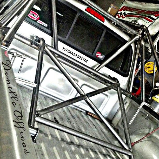

Rack Update
3/28/13
Stopped by Demello today to pick up wheel spacers for the FJ.
Wow, Belle's rack (pun intended) is looking good. Photos below.
42" ELS Atlas LED light bar and mesh floor.
Side profile (sunroof can still be opened).
Swing-up spare tire carrier.
To lock the swing-up carrier in the "up" position, support legs fold down and secure to the floor mounts.
Nearly complete. All that's left are two (2) removable Jerry can carriers (one above each wheel well), some weld-on tabs (for lights, antenna, etc.) and of course, powder-coating.
Suspension work should commence, once rack is ready for PC. My guess is next wk, hopefully.

Also used this opportunity to take some photos of the new rack.
Swing-up spare carrier and removable Jerry can carriers
Roof rack and rear light tabs
Jerry can carrier with lock bar
Swing-up hinges and tabs for CB Firestik and Ham radio antenna
Swing-up support leg
42" ELS Atlas LED
