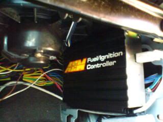

The prototyping of making an AEM FIC PNP. Production harnesses much much cleaner haha.
FIC goes behind the kick panel pretty good
FIC tucked in

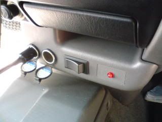

FIC allows you to install an external switch to switch between two different maps. Found an OE looking and fitting switch

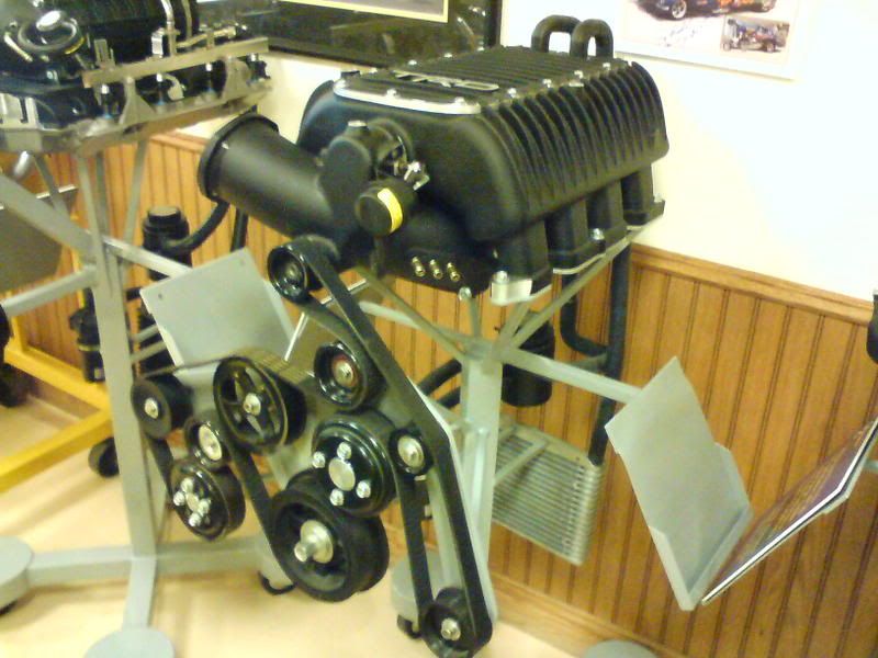

Dropping off S/C at her creators for a rebuild
They had this beast on display
And another of a number of displays

Have a pic of doing some of the amp work, no pic of the stealth box in. Maybe get one later.

Water/Meth is great and all, but I finally put my EMS and upgrades to work by running an E85/91 mix bringing it to about E60 for starters.
H o l l y S h * t. Why did I take soooo long to finally go to that station and rock a tune for it?
I have an OE looking rocker switch in one of the blanks in front of the shifter. Before going to the E85 station I flipped it over to put the AEM FIC on Map "B"- uploaded my Map A then did a quick E60~85 make-over--- added about 15% fuel across the board (should of done something like 20%), leaned out closed loop boost (ran rich with 91 to help with ping) and for the super awesome part.
My 5vz is one of "those" 5vz's that even Gadget has talked about, where not matter what he or his customer tried to dial in, it loves to ping. OE ECU, anything, and I mean just any smidge on the TRD boost gauge into boost-- .00001 psi, and it would start to ping very audibly. The AEM FIC allowed me to run richer and pull timing to dial it out, but oh did I have to dial it out. I had to run a lot more fuel and pull LOTS of timing (there were low gear/high load regions with over 5 degrees pulled). Even with that tuning and timing pulled, sometimes, maybe due to temps, inclines etc, it would still ping! The water/meth finally gave me some relief, depending on the Meth mix I could almost zero out timing and feel a huge butt dyno increase in power.
But, I get lazy, and cheap, and often put just water in the tank, and not meth. The water helps, but only in making the non-water/meth tune a little bit less ping prone.
Then enter the E60 with water/meth turned off, and ALL TIMING RESTORED, all pulled timing cells zero'd out.
The truck pulled like a pissed off raped ape- the 'pingy' noise it often makes that isn't audible knock but IMO something right below it now replaced with a beefy throaty engine sound.
I still have hopes that I do not have burnt valves or some other heat caused damage to my motor from the previous owner that causes my engine to be very ping happy. I'm too lazy to do a compression check or take the heads off to inspect, and the engine runs great except for liking to ping in boost, so I'm crossing my fingers that it was just a lot of carbon build up. Over the years of running water injection, I have to say it got better so IMO slowly but surely the carbon has been getting cleaned out. With the E85 mix, I can't wait to do repeat after repeat after repeat of "Italian tune up jobs" on the freeway to try and blow even more carbon out.
Trov notes: E85 or even down to E60--- f'ing aweseom-- so much fun. I'm really going to need a built tranny now.
