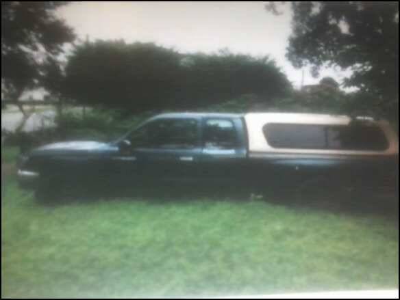

Stonewall sitting in the yard I took him home from back in August:

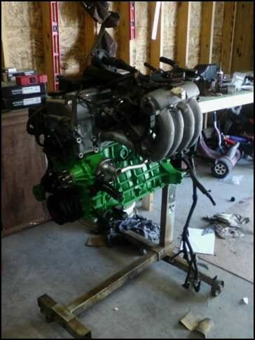

Painted block!
Valve Cover
My truck is Fenwick powered!
Throwin that joker back in there
BAM!!!

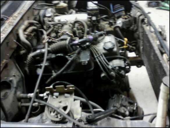

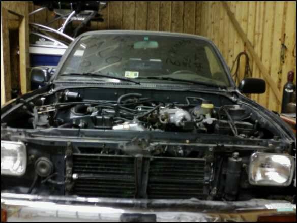

This is all from today. Finished getting everything out of the Engine bay that was in the way. Had to completely cut all of the belts off- they were more or less melted/stuck onto the pulleys, really cracked and whatnot. The fuel left in the lines smelled rank- definitely old. Tranny fluid was pretty much black, but no trash. Everything actually came out surprisingly easy. The hoses were all in pretty good shape, surprisingly. I was quite pleased how easily everything went.
Gonna check out/remove the head and send it to the shop down the street hopefully tomorrow.
Gettin stuff out of the way
Everything ready!
BAM! I WIN!

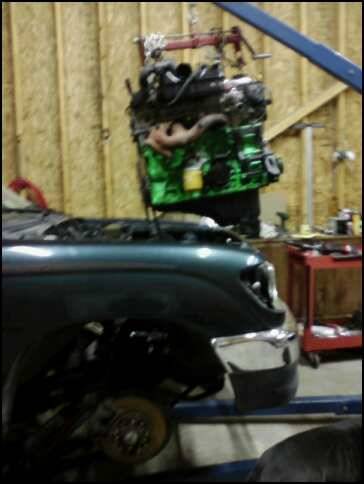

All we did today was take the motor off the hoist and put it on a stand. Then we took it outside, plugged up all the places water could get into, and pressure-washed the sucker to clean it up. My buddy said it's always nicer to work on them when they are clean- this sucker was so dirty you could hardly see half the stuff on it! xD

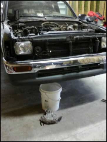

Looks lovely, don't it? Oil is really thick on EVERYTHING- see how thick it is caked on?
Oh, and the tranny is being held in now by a ratchet strap so we can get the truck out of the garage while working on motor itself.

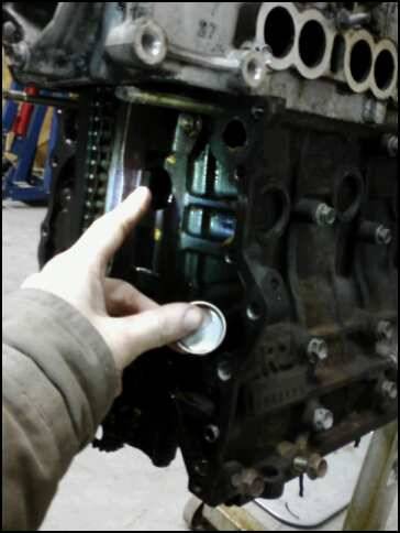

Crazy good news! I may have just been saved a considerable amount of money. Found a freeze plug in the oil pan when I took it off, and later found where it came from. This is looking the whole reason there was water in the oil- from here, the water was able to drain directly into the pan, milking the oil like a blown head gasket! The head looks fine from what we can see- took it off to be sure. Everything is level with the straight-edge, not seeing any scarring or anything.
So now we know for sure that the motor has been rebuilt before- the freeze plugs are all new, for one thing. The timing chain and guides are pretty new, too- the guides are plastic, and have hardly a trace of wear to them, proving that at least that was done somewhat recently. The whole reason that freeze plug came out is because he didn't put any sort of a sealant/rubber gasket to the back of it to ensure it stayed in like he did the rest of them.
On another note, pressure washed the whole sucker down yesterday, including the engine bay of the truck itself. Sealed everything we didn't want water in, and it all looks spiffy clean.

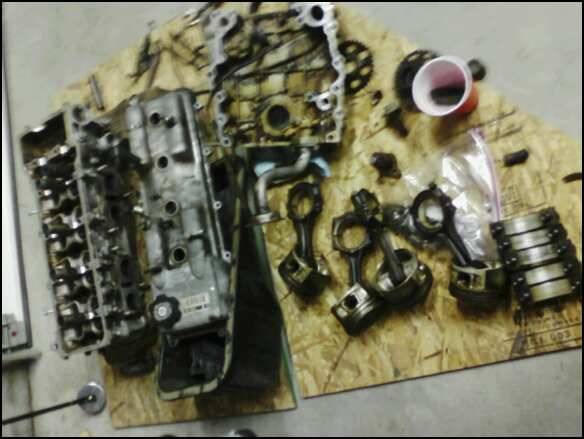

Well, got to piddle with the motor a little more today, got some good and bad news. Went up to Advance and bought a full gasket kit (will be in on the 29th) and a new timing chain, complete with the plastic guides, cover, etc. (will be in tomorrow)
Inspected the cylinder walls, and found that they are not bad- only one very faint scoring line in the second cylinder. When I run my finger nail across it, it does not catch, and it does not run all the way down the cylinder. You can tell that someone has honed the cylinders before because of the cross-hatching left behind. In the same cylinder, there was a very small, thin patch of what looked like rust that rubbed off easily when I touched it with my finger.
We looked at one of the rod bearings (got called in by my buddy's wife for dinner at this point) and found that it was badly scored- yet the crank didn't seem to be harmed at all, at least in that one spot. Seeing as we got called in, we have yet to check the other ones.
So I'll be getting new bearings, probably a new crankshaft too, even though I see no damage to it so far- it's going to be there, whether I recognize it or not, with how bad that bearing was. I'll try and take pictures tomorrow- my phone died today, so I was unable to take any pics.
