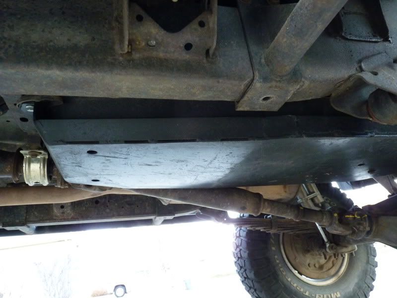

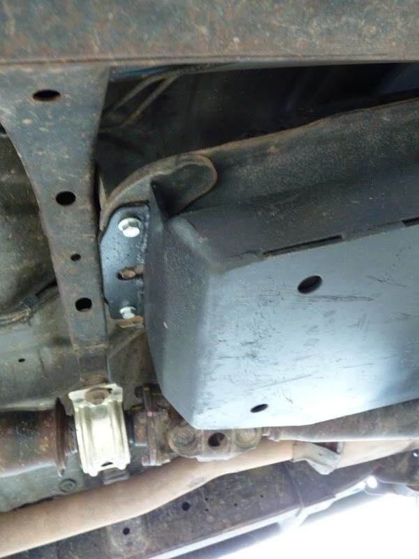

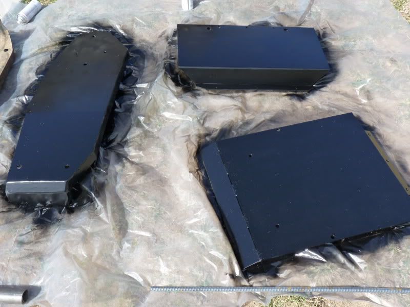

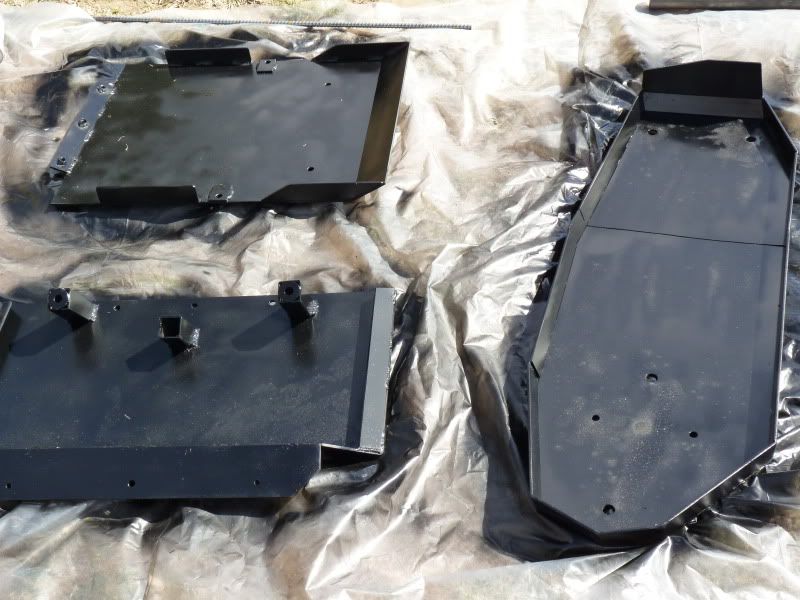

Next came the skids... front, IFS, belly(t-case) and gas tank. My buddy Gerdo (Lil Skips Offroad) really was the one that built them... I just helped out.
