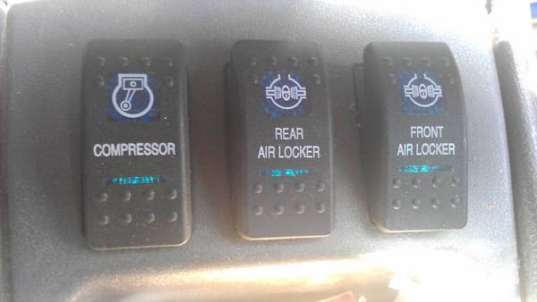

  • OTTRW Switches

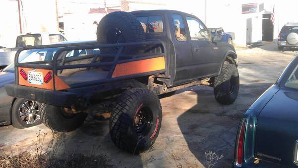

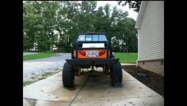

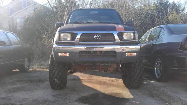

The day I bought the truck. It was pretty trashed, but it was cheap and ran great.
The pic is crappy, but the only one I have. This is the pic the seller sent to me.
It had Pro-Comp coil overs in the front (cranked up to the max), and a 2" AAL and 3" block on it already. It also had 4:56 gears installed, and what I was told to be a front "locker". And of course a "truggy" type bed.

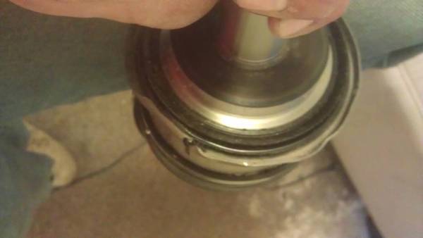

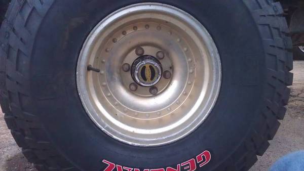

The hubs were shot, and only engaged now and then. I ordered a set of WARN hubs to replace them.

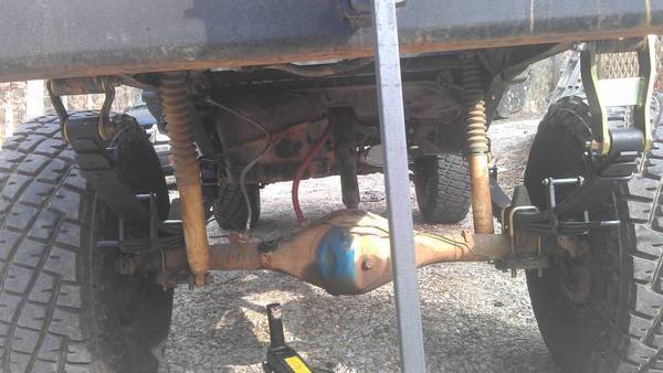

The rear end was leaking pretty bad. We ended up replacing all of the bearing, seals, brake pads, and brake components. Don't have any pics of this because I wasn't there while Bill was rebuilding it.

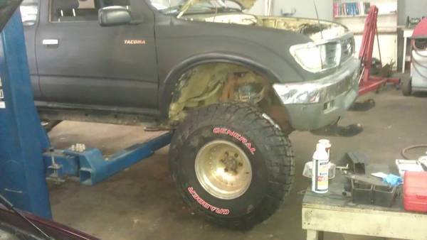

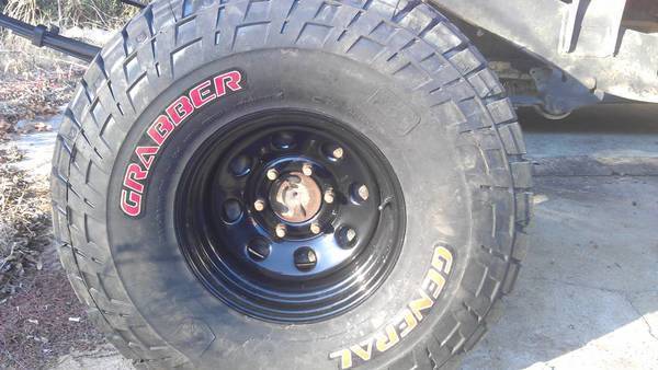

The tires were bald, so that was my next order. Got a set of General Grabber red labels for pretty cheap. 35/12.50/15
Mounted.

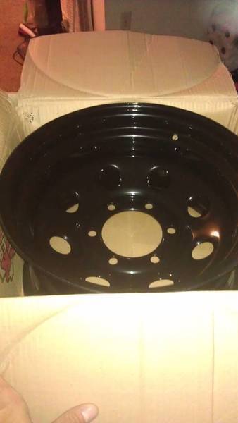

After much searching to find one of those wheels, I gave up and ordered a set of Pro-Comp steelies.

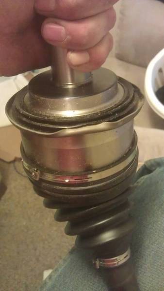

At this point I started wheeling it. My first wheeling trip, I snapped a CV. I went ahead and ordered two brand new CV's, and kept the one good one on the truck as a spare. These are the CV's that I ordered from Autopartswherehouse. Both of them came in bent up. Luckely I was able to straighten them out.

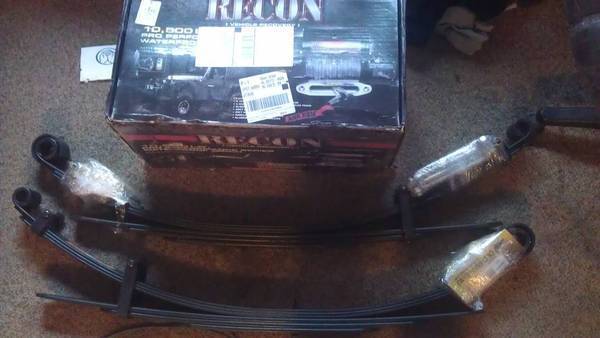

Dakars, and Recon 10,500lb waterproof winch w/synthetic line arrived.

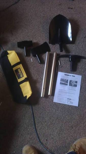

Hi-Lift Handle all.

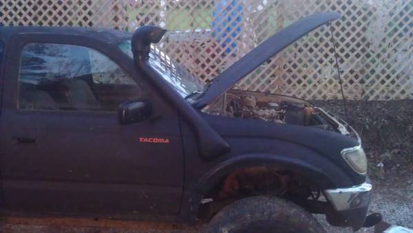

ARB safari Snorkel.

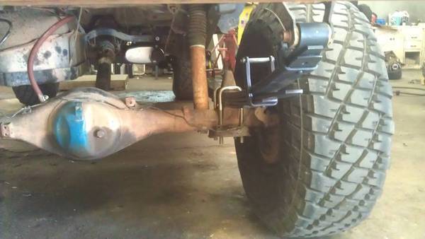

Dakars installed.

2" lift shackles from ToyTec.
ARB Snorkel installed.

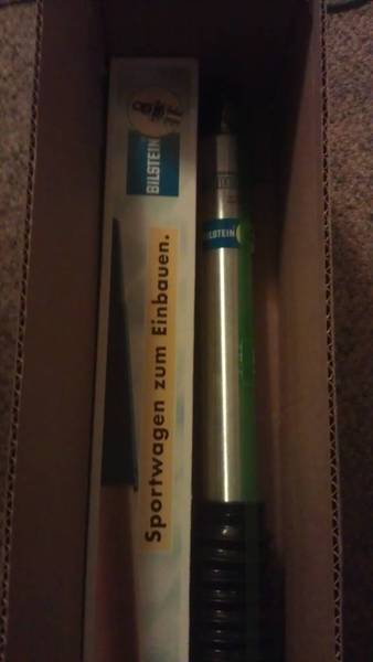

10" billies to replace the old rear shocks.

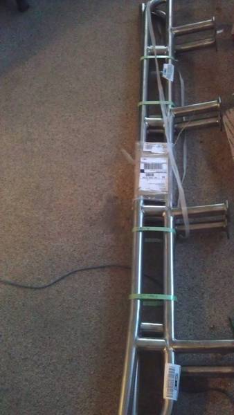

Many items sat around a while, while I waited for Addicted to get the bumper to me.
In the process I purchased front and rear ARB air lockers and a Viair Ultra duty OBA.
Sorry, don't have any pics of the install that I can find. Except this one.

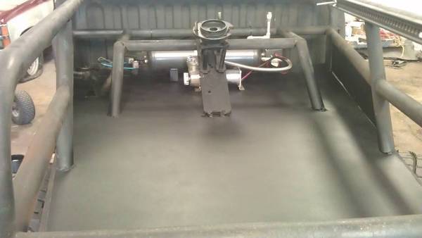

OBA. With my home made tire carrier.
Found a ditch to try out the ARB's. Drove through this in 2WD.
Replaced the Pro-Comp coilovers with OME 882's, nitrocharger shocks and LR UCA's.

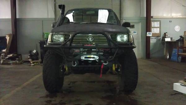

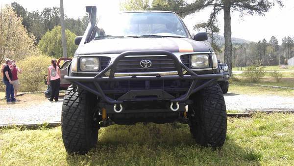

Got my Addicted bumper installed.
Winch installed.
Light bar installed.

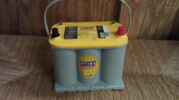

Installed a Optima Yellow Top to run everything.

I'm glad you posted this build... now I can steal ideas! How do you like the handle all kit?
I've used the shovel a couple times, and the sledge once. They seem to hold up well. I love the kit because it all fits in a little bag. Plus, the handle from my Hi-Lift also fits all the tools. I'm happy with it so far.
Nice! I'd like something like that. ...maybe for Christmas
Post up your experience with the axe when you use it. I'm really curious about that.
