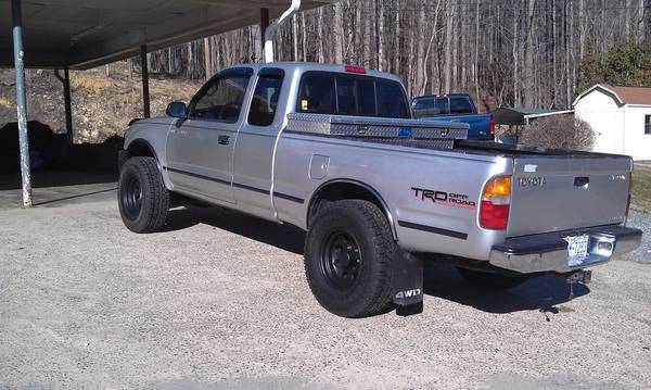

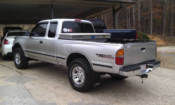

Well I finally decided to make a build thread. Tacoma's are my all time favorite truck and have been since I knew about them. I bought this truck off my old man and it had 222k miles on it. He owned it since 160k so I know all the maintenance history back to then. It was exactly the truck I wanted when I was looking for my first Tacoma so I just had to buy it. I hope you like my truck as much as I do.
How it sits now as of 03/22/14

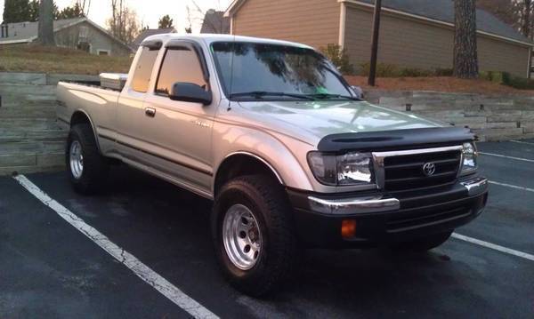

And because I'm a picture whore, the Truck that started it all. My old 96:
Now back to my current. When I bought it..

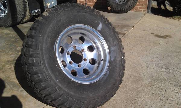

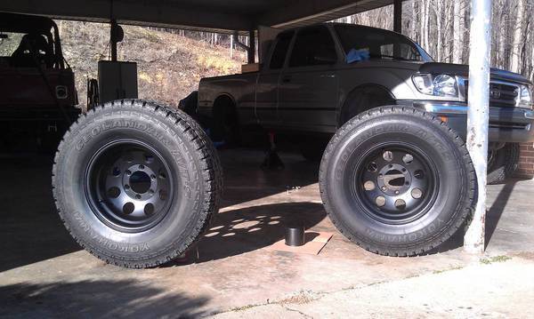

Bought some Mickey Thompson wheels with four mud tires for $170. The tires were on my red tacoma when I totaled it and they had a flat spot from locking it down so I put the wheels on my truck and sold the tires for $200.
The wheels have a really low backspacing so they rubbed. Bent the pinch and trimmed the fender liner.

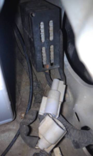

Had DRL's (daytime running lights) and hated them so I disabled them

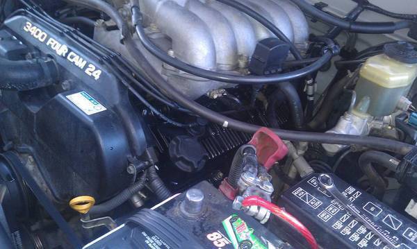

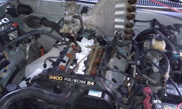

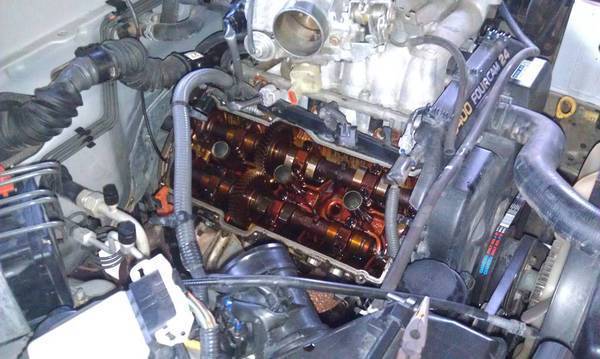

Was leaking oil since I bought it so I did valve cover gaskets and rear main seal.
Painted them gloss black
