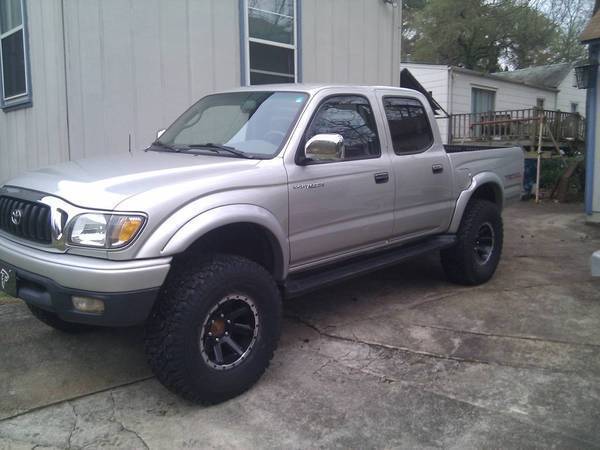

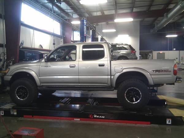

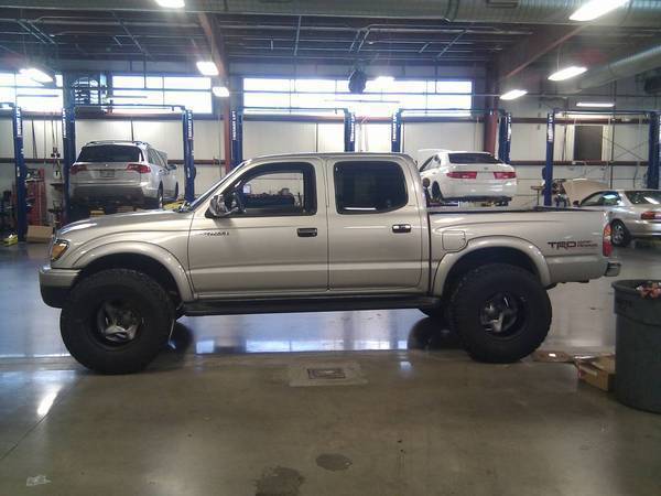

Mocked up some 33x12.5 x15 waiting on wheels and full Lift kit from Toytec 3" OME package.
as it stands now.

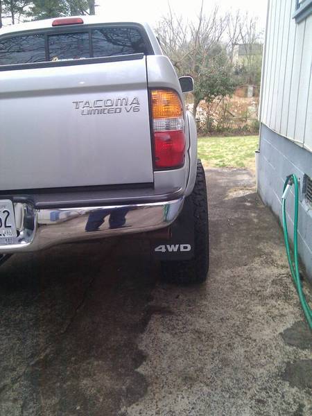

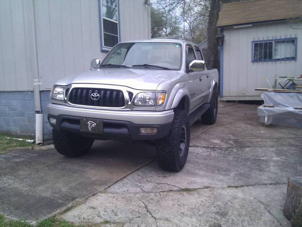

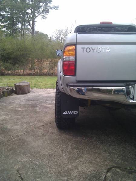

new pictures messing around at work parking lot. Boxrocket inspired the photo's when i was looking at his awesome build.
