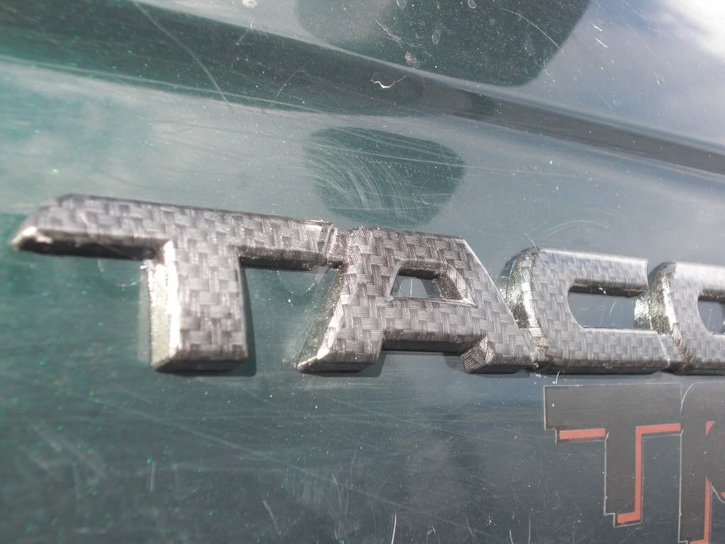

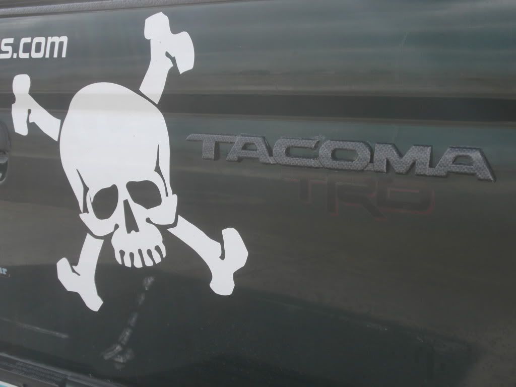

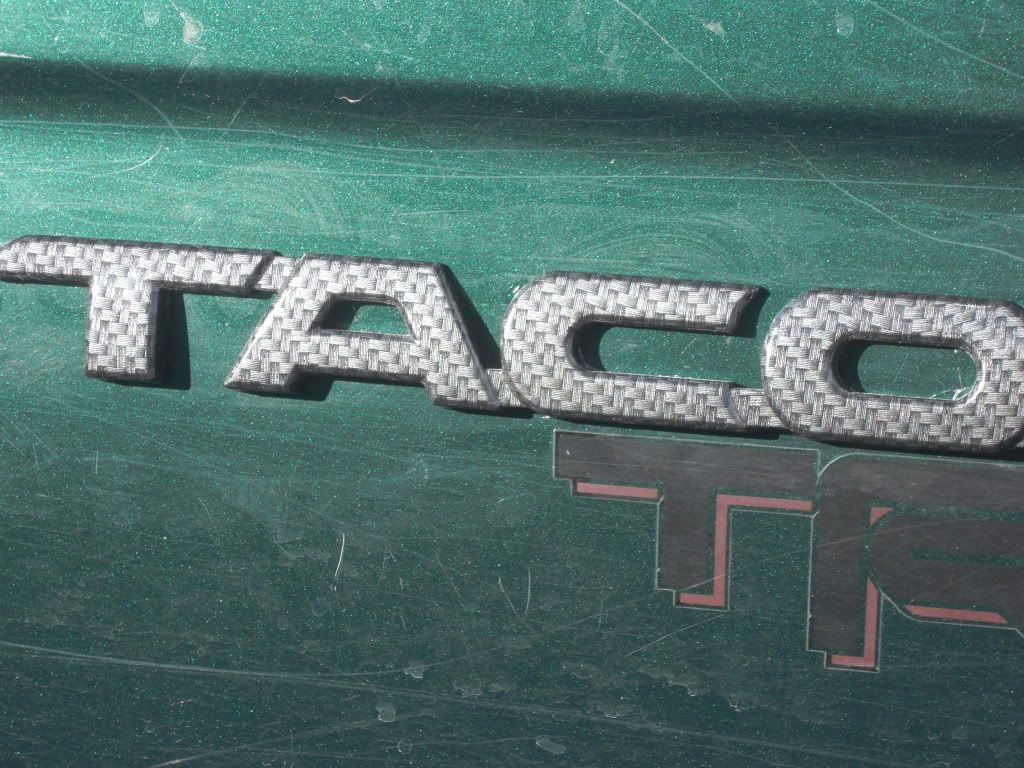

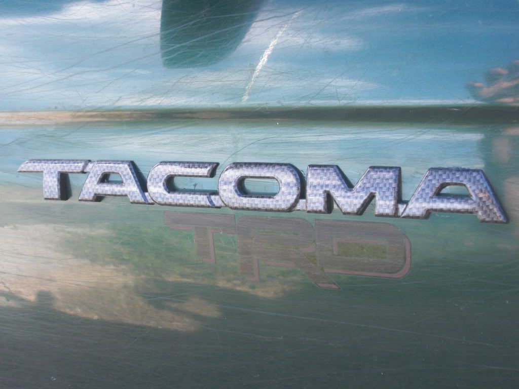

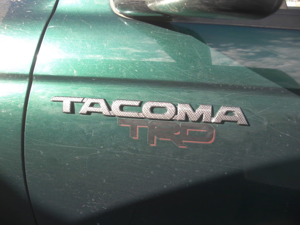

Just got these pretty babies on the truck today!!!!!!

Those are slick!

Nice find!!! dang you got some serious racing stripes goin on. lots of fun had to have been had gettin those!

These were stock 2nd gen badges. I sold my mudflaps to a fellow tw member and purchased them from craigslist. Right now they are one of a kind! Depending on the interest they can be re-created. The process is kind of complicated. Some of the az guys have seen my interior its pretty diffrent. I have more woodgrain in my base model then comes in a luxus!!! Plus theres the carbon fiber accents that match the badges in my op.
Im debating on taking this the next step and doing work for others. At this time I dont have facilitys to make it happen. Please TW tell me what you think so far!!!

not a fan of woodgrain, definitely not w/ carbon fiber-- just doesnt look right together

I dont want people to be confused. This is NOT actual carbon fiber or woodgrain. All the parts are stock pieces. They have been hydroprinted to look like carbon and wood. I have other patterns and can get many many more. Everything from simulated water drops to diamond plate. carbon fiber to camo. Anything that can be safely submirsed in water can be hydroprinted.

Ah but the problem is that the "how" is where the money is made.
An image is printed on plastic based film . The film is placed in a tank of water. A chemical activator seperates the image from the film. The image floats on the surface while the plastic sinks.
After some very careful prepwork (sanding, painting, priming, things of that nature). The part is submurged in the tank thru the floating image.A quick wash to remove excess material . Then comes a dry time and quality control inspection. Once everything is perfect an automotive quality clearcoat is applied then sanded and buffed to a high shine. Many images and patterns are available, some images can be combined and there are a few other tricks that can make custom one of a kind projects possible.
