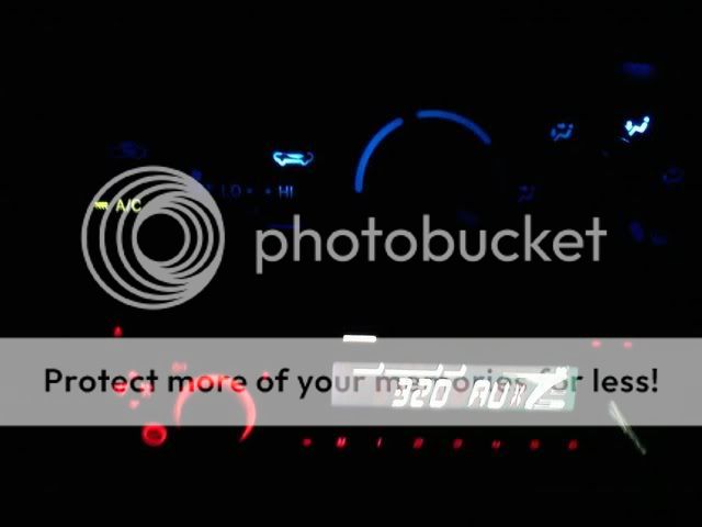

My LED Gauge and AC Lights Install
The guidline to doing the install can be found here.
http://www.customtacos.com/tech/index.php?article=77
Ok heres what I used for the install
For the gauge cluster led's use 194's and you will need 2 of them if you have no tach and 4 if you have a tach. Make sure to get the leds that have 5 led's and that use a wide angle like these.
http://www.superbrightleds.com/cgi-b...cs/WLED-x5.htm
For the A/C controls it requires #74 bulbs it takes 2 for the controls and those bulbs can be single led's like these.
http://www.superbrightleds.com/cgi-b...pecs/74-x.html
If you follow what I said you will have results like mine(I used all blue led's).
If you guys have any questions just let me know I'm here to help.
