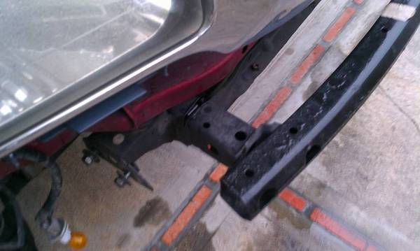

hey i got my allpro bumper today and i have a question how exactly do i get the metal piece off the long one i guess its the factory bumper i took off the two bolts underneath each one but it wont come off do i need to cut this off or am i doing sumthing wrong here look at the pics please help
this is what i cant get off bolts already removed

this might help
the green hoop shows you where to go but its mounted to the frame at the base so use and extension

thanks
thank you very much i was close to just cutting that thing off lol

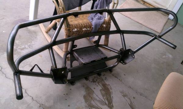

another problem
well i guess allpro made my bumper just about 1/4 to 1/8 of an inch to narrow and i cant for the life of get it inbetween the frame rail dang it should i grind it just a bit

its supposed to fit tight.. anyone around you to lend an extra hand?

x2 my trail gear bumper was a PITA a second set of hands make a world of difference

yeah mcjosh was a big help when i put mine on.. i still couldnt get one side of the bolts to line up and now its way out of alignment lol

It's still too tight about 1/4 off what should I do

Beat the shit out of the bumper and make it fit.
Is there anyway you can get a hi-lift jack inbetween the 2 mounting brackets and spread them ever so slightly?

Are your mounting brackets painted? If so you may have to take the paint down to primer then mount it. My tg bumper took alot of persuading to fit. so keep trying before taking it down

its done gentlemen thank you very much for all ur help 6 pack on me here are the pics need to paint it later its just got sum spotty primer on it for now used a sledge hammer to persuade it into place and my two brothers let me know what you think
