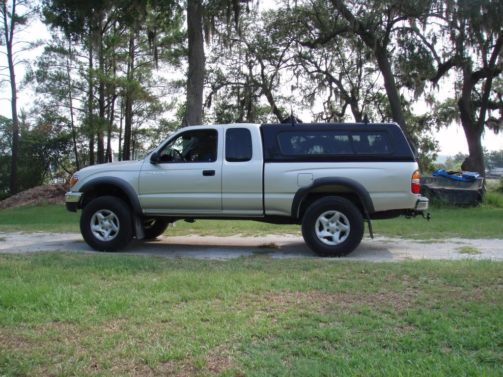

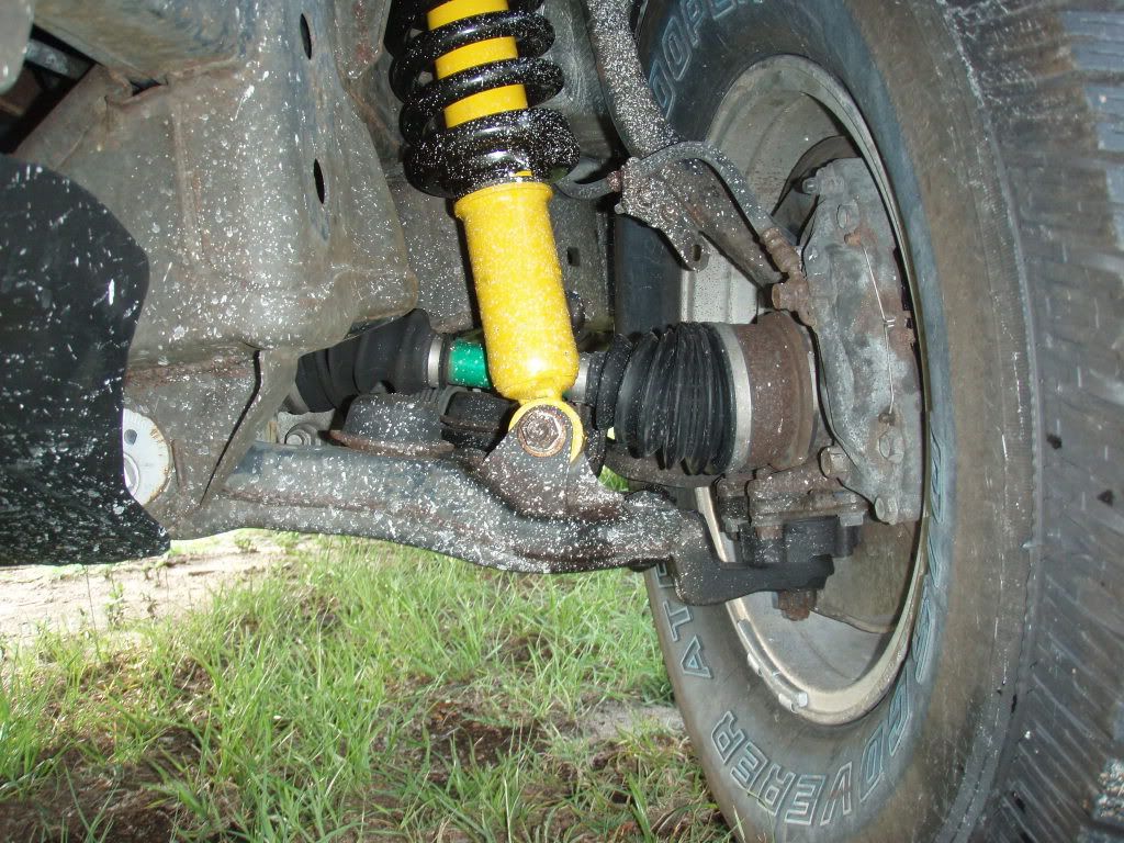

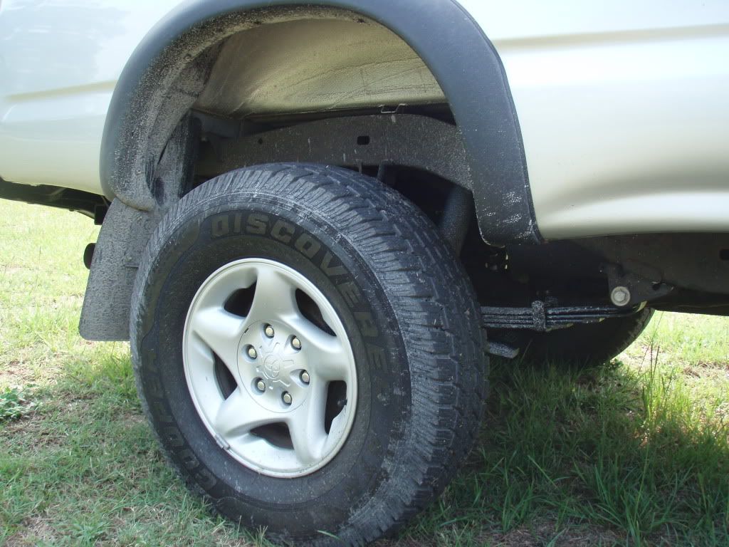

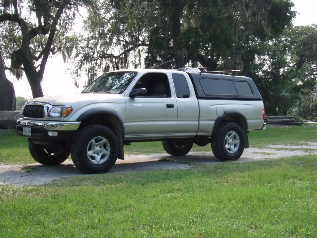

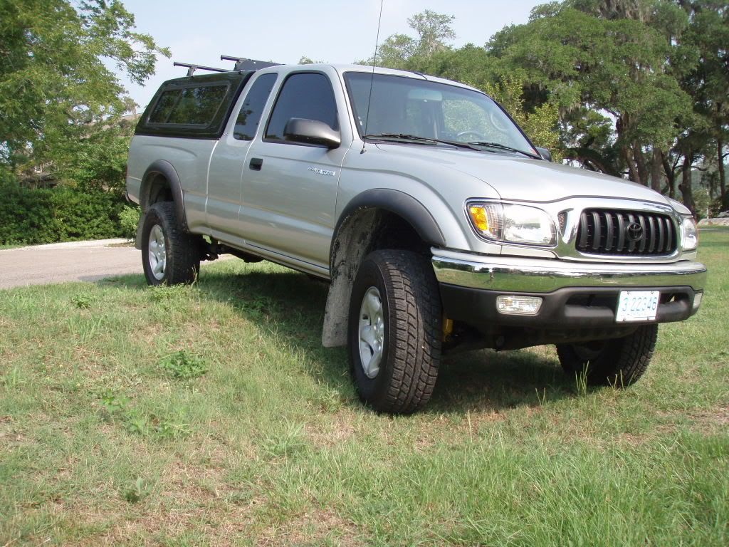

Got the truck back last night and took some pictures this morning. Here it is!
OME Nitrochargers, 881s with trim packer on driver's side, Wheeler's 5 leaf pack, extended brake line.

You feeling pretty confident about the cv angles ? i have the same front setup, but i ended up putting the diff drop in. The flutes on the inside were just about touching, but that settled in on its own in short time. I knew the drop kit wouldn't do much (and it didn't ) but it did a little....... i think. i figured for 25 bucks why not? you thinking about splurging on it or satisfied as is?

I have looked at a bunch of the guys that bought 881s and it doesn't seem like they have had problems with their CV angles. They are a little steep right now but I think they will settle in with time and will be okay. For right now I'm not doing a diff drop

in hind-sight i feel the same. after i put the new struts on, i lowered the truck from the jack stands, and looked at it, and that is when i decided on the drop..... i think driving it for a few days would have swayed my view. looks good though either way
