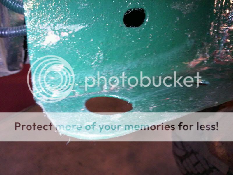

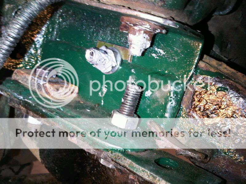

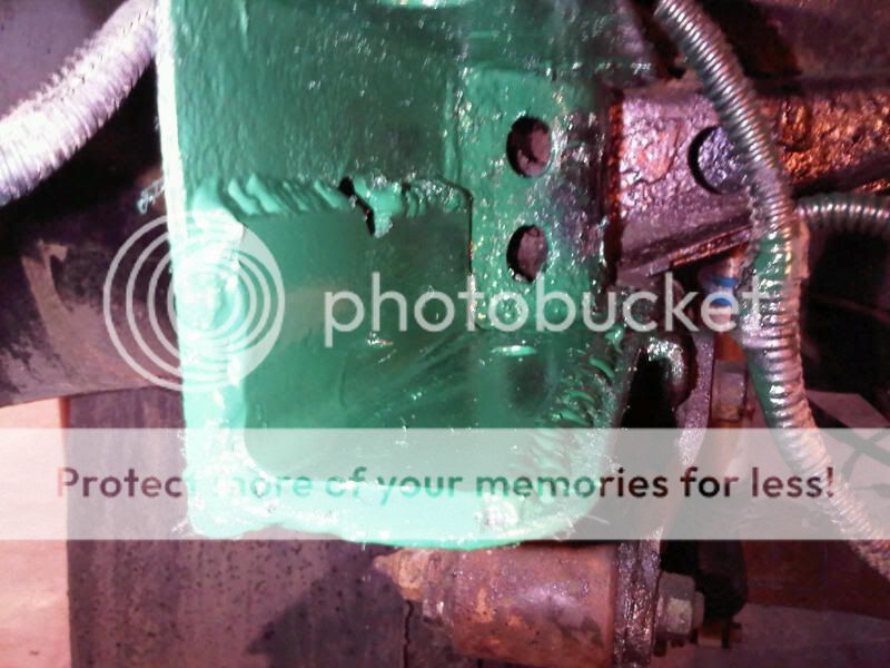

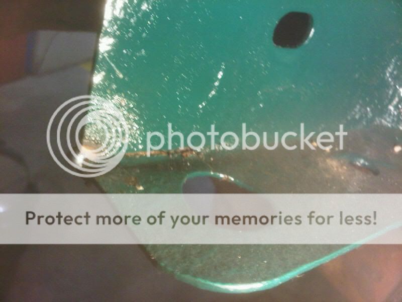

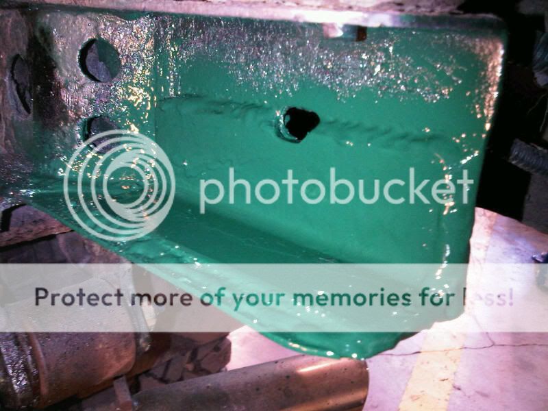

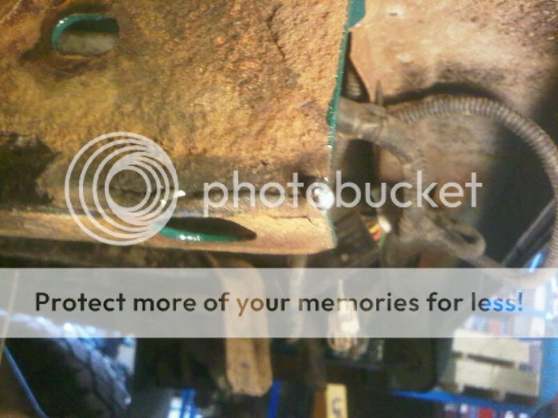

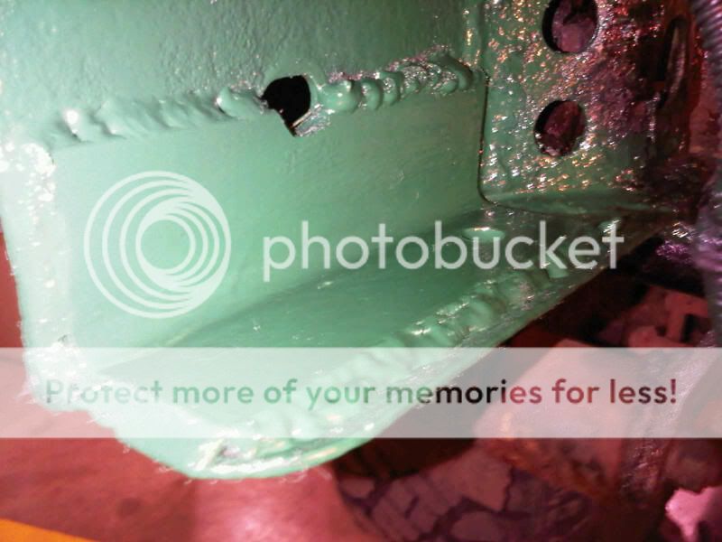

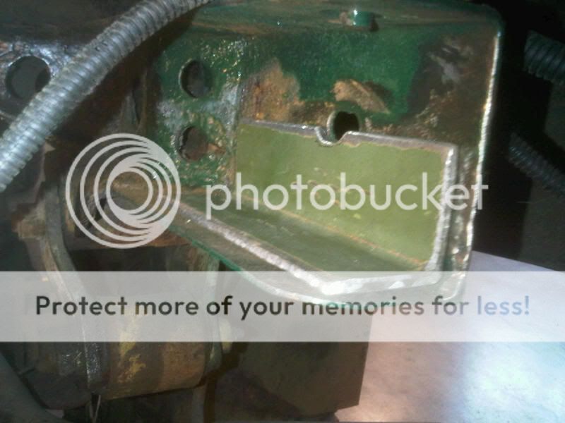

Not soon after I bought my truck (year ago) I noticed that end of the frame where the Class 3 hitch mounts was split. I dont know if this was caused by the PO overloading the hitch or something. Anyways, Ive done my best not to tow anything until I had a chance to fix it. Most I was willing to put on there was my brothers 12' boat.
I recently got access to a small MIG welder soo I thought this would be the perfect time.
So as far as my welding "skills" go...I am self taught and have only welded a handful of scrap pieces of metal together to get a hang of the amperage and wire speed settings.
All I needed for materials was some 1/4" angle iron. About 30cm in length total.
Here is what the splits look like. This was after bending them back into place and throwing a tack on. It was the same on both sides and opened up a lot when the hitch was mounted.
Crack welded
Here is the piece of angle iron prepped and in place on the right frame rail.
Welded
Painted
Left side welded and painted
Bumper and hitch mounted
Well ive got a little more piece of mind now about towing! I realize my welds are very very far from pretty or perfect, but i think they will work lol
Cheers TW!

Looks great, I would for sure feel confident towing with that repair. Probably better than I would have done.
