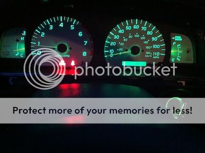

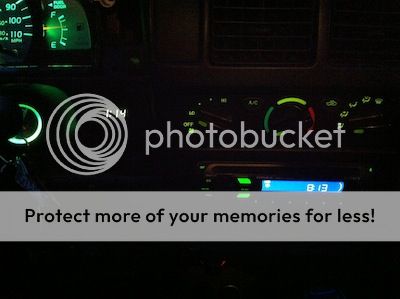

All my LEDs will dim via the dimmer knob...
Here's my black ops green theme:
More detailed pics on my build HERE.
