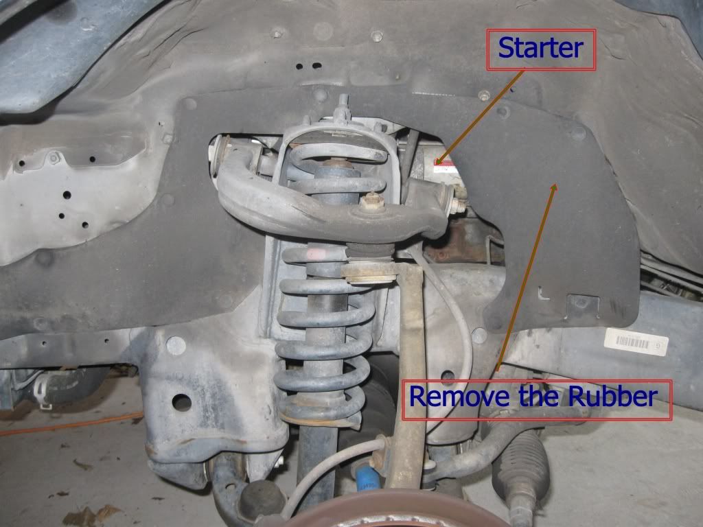

STEP THREE: Remove the rubber piece
This will give you direct access to the starter. Look through the wheel well and you will see it.

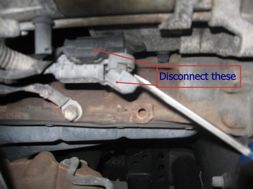

STEP FOUR: Disconnect the connectors
Take a screwdriver and pop the plastic cover back so that you can access the nut.
Take a ratchet and remove the nut.
Take a pair of pliers or a screwdriver and disconnect the black connector.

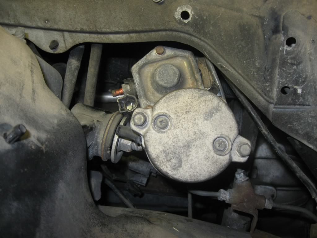

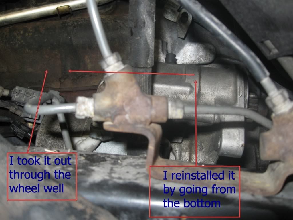

STEP SIX: Remove the starter
Maneuver the starter until you can get it out. I spun it around and went out the wheel well.
It is probably possible to get it out underneath but I decided that taking it out the wheel well was easiest for me.

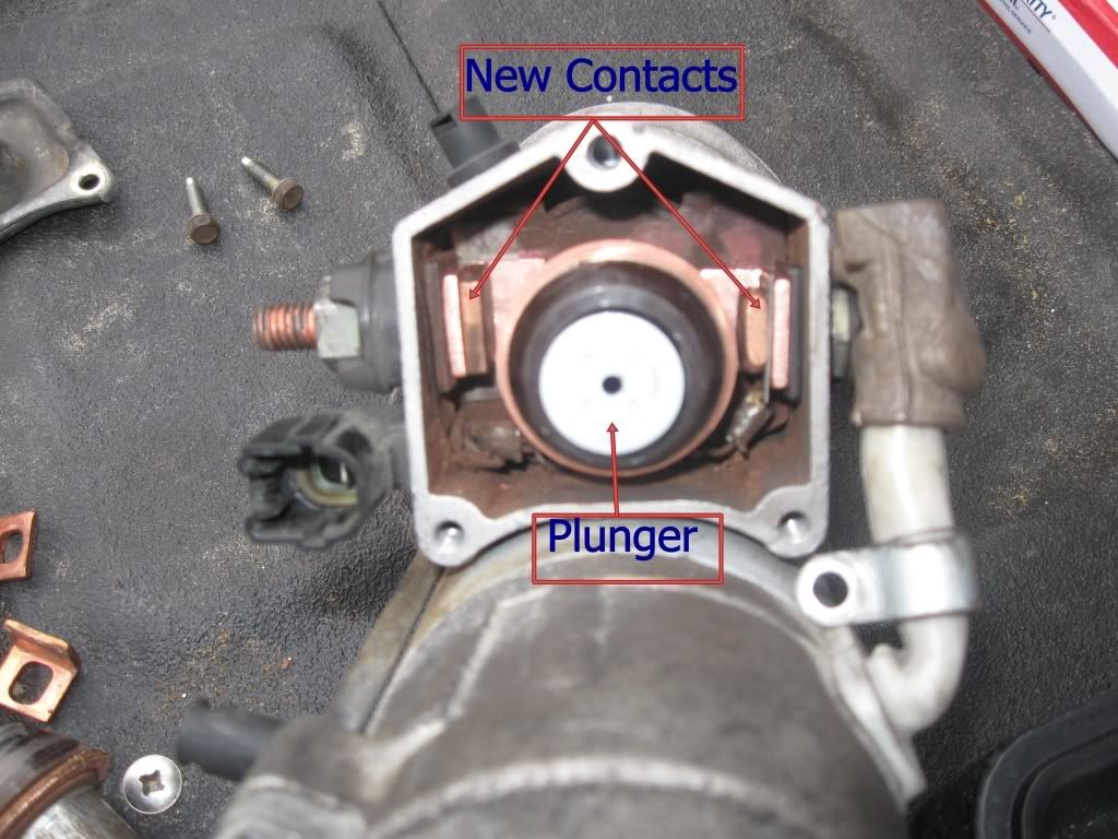

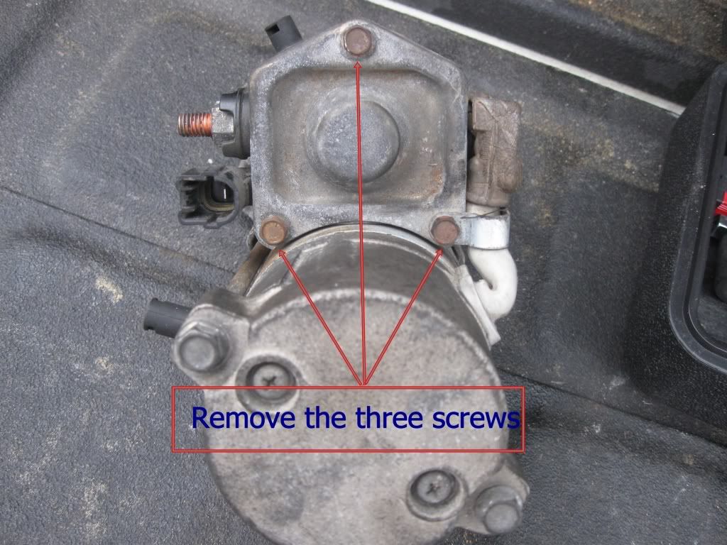

STEP SEVEN: Remove the three screws on the cover

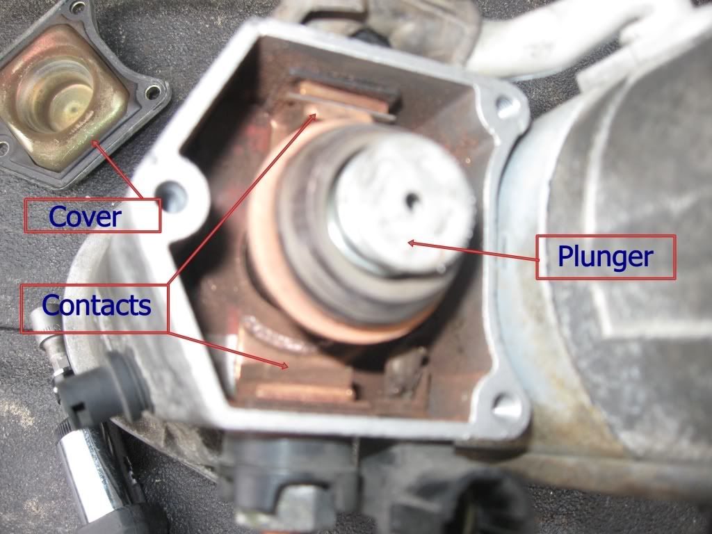

STEP EIGHT: Remove the cover

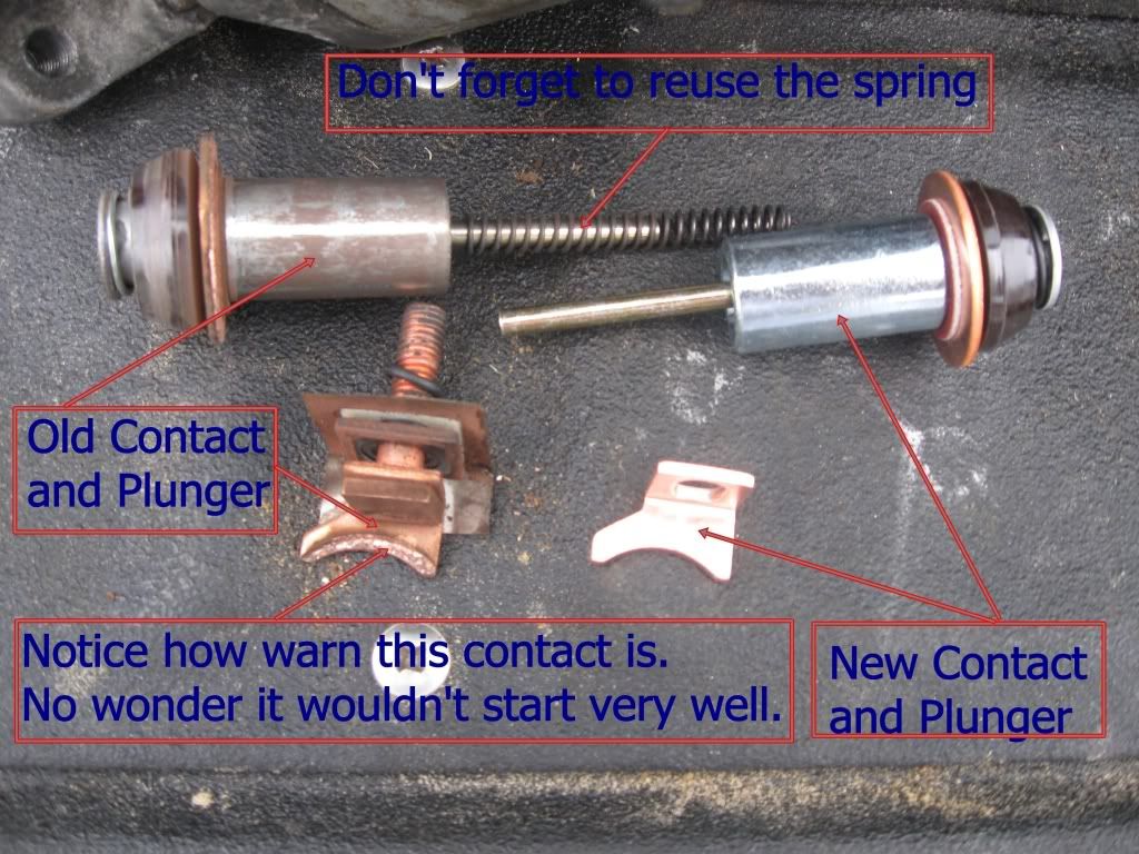

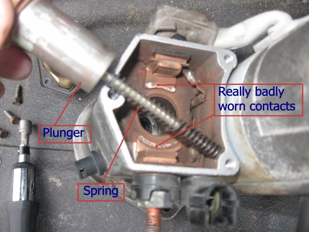

STEP NINE: Remove the plunger (donít lose the spring)

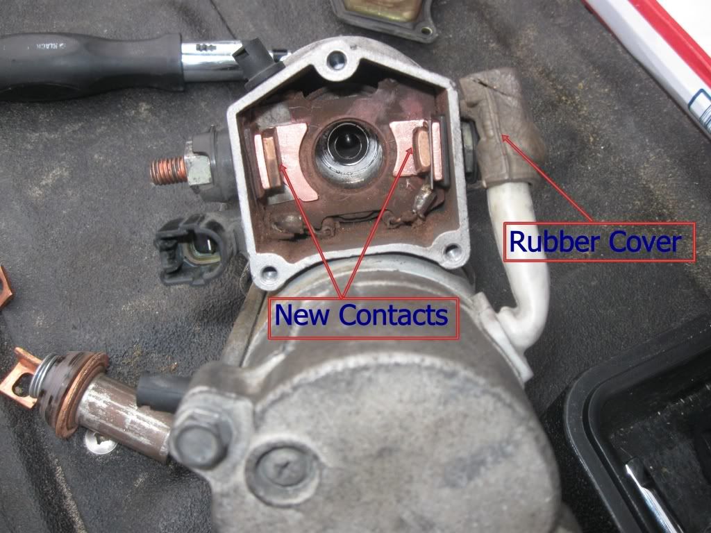

STEP TEN: remove and replace the contacts

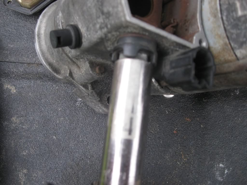

Take a socket and remove the nut on the outside of the starter holding the contact in. Install a new contact. Make sure you take note of the way they come out so you can put them back in the correct order.
Take the rubber cover off and take a socket and remove the nut on the outside of the starter holding the second contact in. Install a new contact and tighten the nut up and put the rubber cover back on.
STEP ELEVEN: replace the plunger and spring

STEP THIRTEEN: reinstall the starter
I decided to reinstall the starter by going underneath and sliding it to the left instead of through the wheel well. After a bunch of maneuvering I finally got it in place. There isnít a whole lot of room to move it around so be patient. Just keep turning it around until you finally get it in place. Once back in place, reinstall the two bolts (donít forget to attach the wire on the top one).

Thumbs up 2000 Toyota Tacoma Update 02-02-2013
February 2, 2013
Ok so hereís what I found when doing the starter on 2000 Tacoma, with the 2.7 liter engine.
Find the picture right below Step 6,
I could NOT get the starter out, not at all.
Yes loosened the brake line bracket, but NOPE, still no go on removal.
BUTÖ..it came out just far enough to be able to replace the contacts while in place.
I was able to move it just forward enough to be able to access both sides of the contacts and replace them.
And Iíll say I found this much easier than trying to remove the starter.
It was a no go on taking it out via the wheel well, and there was NO way it would go back into place from the bottom up.
So as you see in step 6 you can pull the starter out just enough to be able to access all three of the small screws holding the cover and both contact bolts.
Also there was NO WIRE on the top starter bolt or the bottom for that matter.
I did have to go to my local Toyota dealer for my contacts as I had to do my starter, the Saturday before Super Bowl 47 and well as you can guess, the contacts were 300% more than anywhere else, so they nicked me for $37.95 (NO PLUNGER, JUST CONTACTS)
But they did have them and none of my local parts stores did, here in the Seattle area.
And all of these steps provided here, were of great help, great help. Just no removal on my end but it can be done through the wheel well.
It starts GREAT now.
AND YES, THE FUEL FILTER IS A MAJOR B!$*&. But it had to be done at 125000 on my rig and it was so clogged it wasnít funny. Ah the purity of gas in our time.
Anyway hope this helps those with the 2000 Tacoma, with the 2.7 liter engine.
Good luck and keep the faith.
