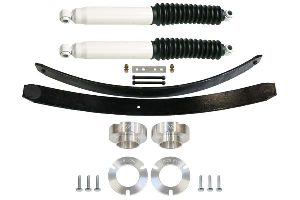

Im looking to get this lift kit
from wheelers. would i need to buy extended brake lines? and possibly extend the 4wd? Please let me know
Thanks

You will not need extended brake lines. And what exactly do you mean by "extend the 4wd"?
also there a alot better kits out there, for not much more $

no. In my experience, blocks ride like crap, even compared to AALs. They also wear out the leaf pack (while AAL's at least extend their life) and, like KPT said, promote axle wrap.
OP, have you considered spending a bit more cash for a coil lift instead of spacers?
Generally the answer you'll get on here is to avoid spacer lifts, they can cause too many problems if you drive offroad and stiffen the ride considerably.
Also, what do you mean by extend the 4wd? Theres no way to do that...

Here you go OP, for only $75 more, you can get Bilstein 5100 adjustable shocks for the front, and a wheelers AAL w/ 5100's for the rear. That's a very good quality lift for those on a budget.
http://www.wheelersoffroad.com/9504tacoadjbils.htm
http://www.wheelersoffroad.com/9504tacoaal.htm

The ride will stiffen, because you're adding pre-load to the coils to get lift
Setting them to the middle setting will level the truck out without an AAL, and will level it at the top 2.5 setting WITH the aal
Do you plan on wheeling?
