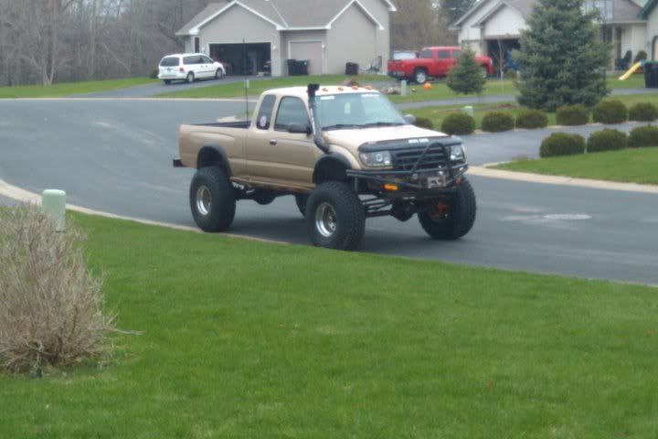

I used a 2.5" PVC pipe.. It's kinda rare I think to find it in that size, but its the perfect size.
Haha my only good snorkel picture, and its pre SAS!

Thanks, I spent $125 on it, and thats including the $85 Safari Snorkel head.

I broke it once, wasn't watching my passenger side and a stump sticking out of the riverbed busted it off.
It doesn't leak, and is sealed 100%, hand over the snorkel will kill the truck isntantly.

How do you have it routed and filtered under the hood

I used a flex pipe, pretty sure its for an intake for the stupid ricers kinda. It follows the original intake in the fender. Epoxy, gorrilla tape, and hose clamps my friend My snorkel is 100% Sealed. Hand over the vent and truck dies instantly
