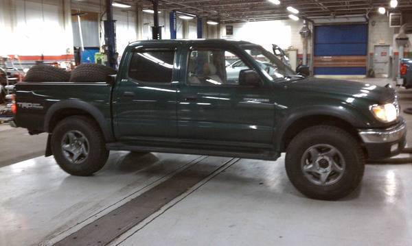

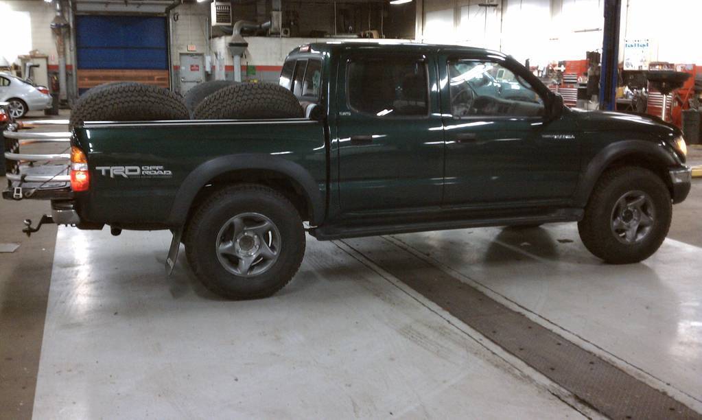

Painted my stock rims graphite and wrapped them with firestone winterforce 265/75/16 tires
(ran out of paint so havent done center caps yet)
No rubbing at all with tires and stock suspension. If Im at the right angle and at full lock I would rub with my 265/70/17. (prob because of rim backspacing? 17s are 2gen sport rims)

Nice. I rub on the frame at full lock and turning left. Very minor though.

What brand paint and any special preperation, let see pic's when you get the center caps painted and on.

Graphite looks great with the green.
Any pics in day light?

looks good

For prep I used Aircraft remover to get rid of clear coat still on and clean it up a little. Then I sanded it down and cleaned it up with acetone (which I tried on my fender flares and it blackened them up and havent faded yet after 2 months). Sprayed a couple coats on each wheel and all done. I still have the can so I'll look to see what brand/color code I used.

The graphite looks good w/ the green truck.
I have been considering painting my rims a similar color or black for a while now.
