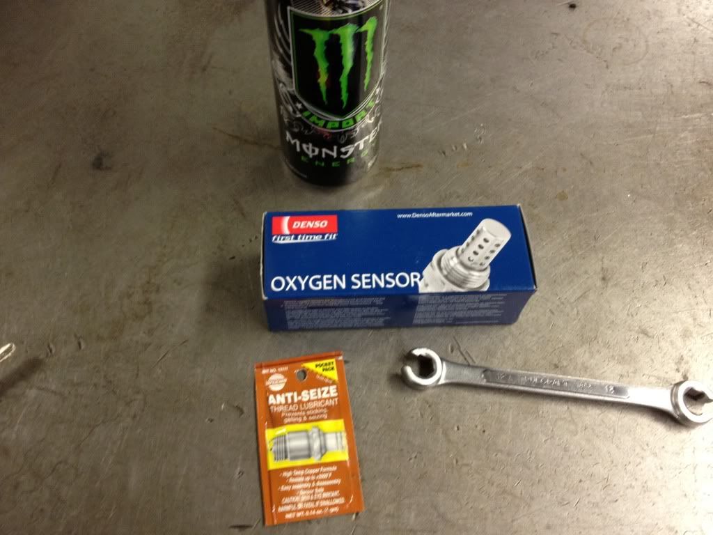

    Materials needed:
    • Note: The type of transmission, drivetrain, and Emission type will change the part number for your O2 sensor.
    • Also note: OEM sensors are DENSO. Many folks have put in Bosch or "universal" only to have them fail a few thousand miles down the road.
    • Also Also Note: Line wrenches are a life saver, because more than likely the nuts holding your sensor in place are fairly rusty and corroded, and a normal wrench has a higher propensity to strip them smooth.

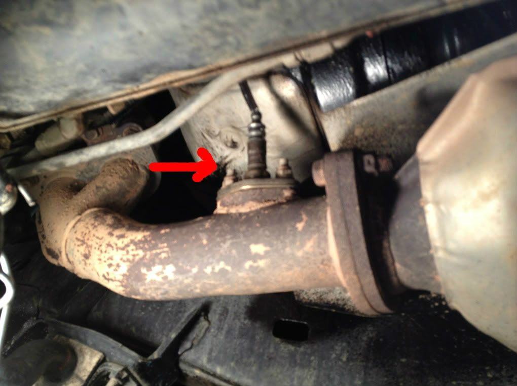

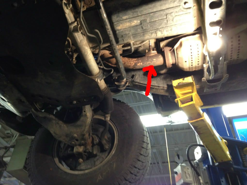

    I figured this would give a clearer picture, of "where exactly" the 2 Oxygen sensors are.
    Step 1: Unscrew the 2 nuts retaining the bad sensor.
    Step 2: Unclip harness. Use a screwdriver to pry the retaining tab off of the hook
    Step 3: Remove new O2 Sensor from box
    Step 4: Clean the area
    Step 5: Put sensor in, and apply anti-seize lube to bolts
    Step 6: Tighten nuts back on, and tighten the sensor *firm* but not to hard. Its not pressurized like a spark plug, so it doesnt need to be torqued down. Just tight with a quarter turn for peace of mind
    Step 7: Plug in connector
