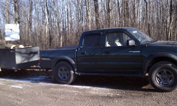

I'll be towing a 16' bass tracker boat alot and looking for a little "help" towing it. I didnt have any problems last summer with it but heard the Timbren kit will help with sway and wear on suspension parts
I will also be towing a polaris ranger, or a 4x8 trailer loaded with wood once in a while
like to stop this from happening or atleast make it not as bad....

Nice, spidy. You improved my post. What's more, it looks like one of us copied the other one's life--I will be twoing 16' boat and occasional 4x8 trailer full of wood. You say you got new leafs and shocks a year ago? What did you get and how did it work for you?

I had them on my '99. Great product. Ride quality was decent when loaded. Not soft but certainly a lot better than riding the bump stops. One issue I had was my leafs were so shot that the truck constantly rode on the timbres. By design they are supposed to only kick in when your truck sags more than one inch.
