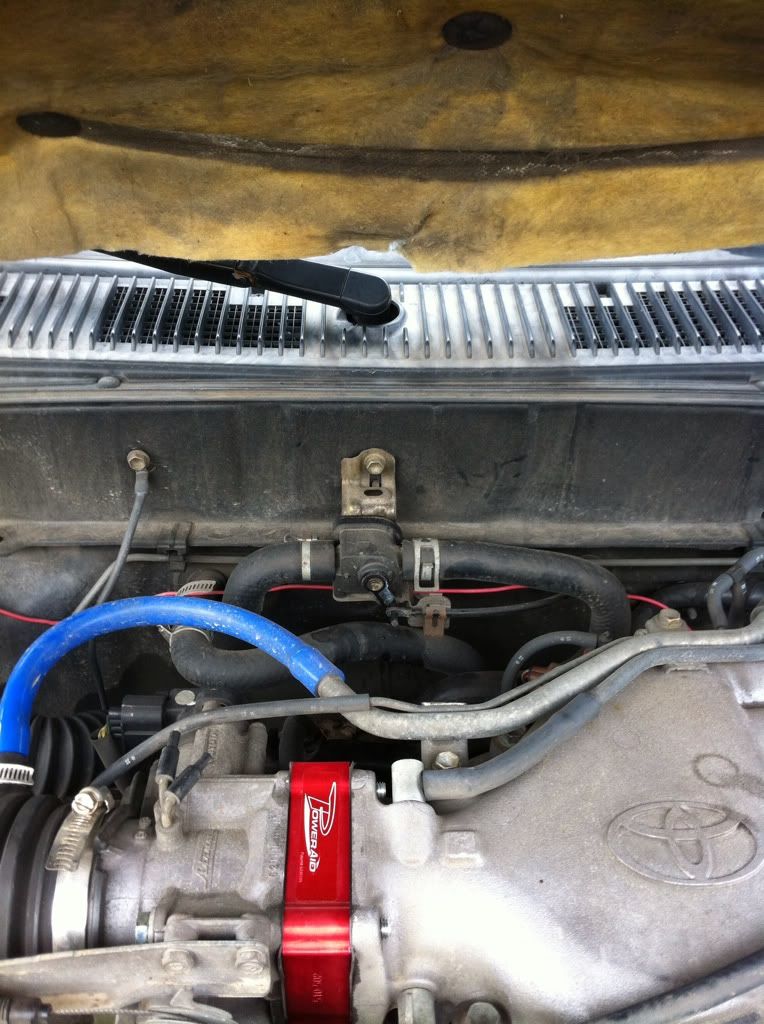

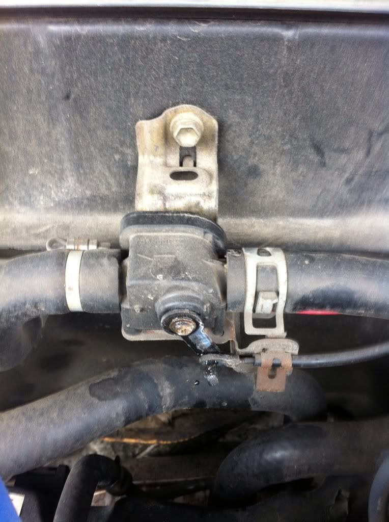

I been trying to find where my antifreeze has been going and i finally found it. Ive been searching up and down my engine and its this little thing? Looks like its coming out of the screw.
Wheres its at
Closer Up
You can see on the hose under it where its been leaking.

thats your heater valve. notice the lttle cable there that runs to your dash and controls when you have hot air

is the screw removeable? prob just has an o-ring inside that is worn out. that would be a cheap fix if that was the case. good luck
