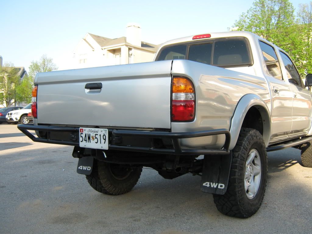

    I really wanted a high clearance wrap around plate bumper with tire carrier. But this one was a good price used and I'd need to hit the lotto to get that bumper I really want:( The ol' trusty allpro will be serving duty on RTO for quite a while.
