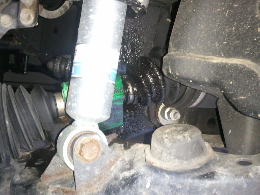

While working on my truck I noticed a lot of grease by the cv axels. In your opinion do I need to replace them?? When is a good indicator to replace your cv axels?

Grease leaking out doesn't necessarily mean your CV axles are shot.
It could only mean the CV BOOT is ripped, torn, or loose. Check your CV BOOT for damage. YOu'll probably need to change the CV BOOT and replace the grease inside.

First do as suggested above. Clean up the area and look for a hole in the boot or a bad clamp.
Assuming a hole in the boot then next question is do you hear any noise while turning or slowing down in a straight line? On the turn it would be a sort of clicking or even knocking sound. Cut the wheel hard and drive forward. Do you hear click, click, click etc.?
When coming to a stop in a straight line, if you let it slowly stop do you feel a thumping through the steering wheel or does it seem like the vehicle is not stopping smoothly? Could have a thumping sound or could just feel like the truck is driving with a flat spot on a tyre for want of a better description.
These things will give you an quickly indication on what work you might need to do.
The "depends" part comes in on if you are going to do the work your self, have the tools and have the mechanical ability (no knock intended in the least, just a matter of what you are comfortable doing mechanical wise).
If you can do the work then a noisy axle is best to replace. If it has not long started leaking, no noise or rough operation then you can pull the axle down, clean out ALL the old grease (I like brake clean to get the last bit out). Let it dry and then re grease it well and put new boots on it.
If you are taking it to a shop to do, especially the dealer, then explore your options. Even if it just needs boots I'd still check to see what the cost is to just replace the whole axle.
Example, I pinched a hole in a boot on a Camry. Leaking out the grease so needed a new one. Was feeling lazy so called the local dealer to see what it would cost to replace the boot. Gave me the price and then asked about the whole axle. Said that they had good luck using a reman axle and cost wise was only a little more than doing just the boot job. Issue was with just the boot I'd be paying labour to remove the old boot, clean everything up, re grease and then install the new boot.
Hope that helps.

Thanks a lot! I do not hear any clicking and my stopping seems normal. Might have just torn a boot. I've seen how to change the cv axels, but you are right, it's what you feel comfortable with. Looking in the manual it does say to change the timing belt at 90,000 miles. I guess I'm 16,000 miles over due. Thanks again.
