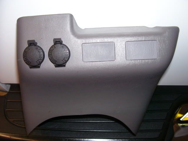

Two blank spots beside the power outlets?
I have two blank covers to the right of the two power outlets under the ashtray on my 1st gen. If these had something there from the factory, what would they be??

Security system

Thanks! I searched high and low for a stock looking switch that would fit into these spots. It took just a little bit of shaving to get then to fit perfectly They are Sea Dog Line IIRC.. I posted it in a switch thread a while ago, I would post it here but I'm on my phone

Does the security system use both spots?
Those switches look perfect. I would like the link for where to purchase them when you can.

Yes. One is for the Led to show its on and the other i think is a button to shut it off(not exactly sure on the botton but i believe so)

I grabbed a hazard flasher switch from the junkyard, wired the grounds to the two 12v outlets throught it. I then removed and jumpered out the relay, making the outlets on all the time, unless I turn them off via the switch.
The top outlet is separately controlled, it still operates by the ignition switch.

Getting in there is nothing, how far you want to put the rest of the wiring can get tricky. The panel just clips in with the pins on the sides. Then the sockets have plugs on them.
