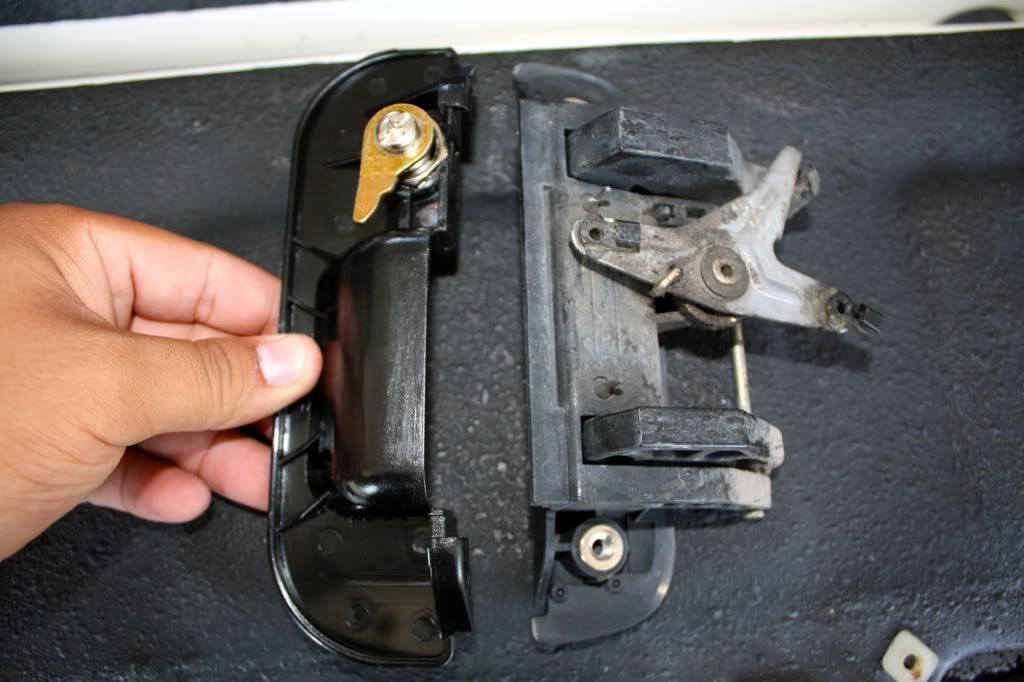

After pulling the handle out, you should be looking at this:
Take the handle and the lock assembly. The lock assembly should slide right into the back of the handle. Remember to connect the two very well so that they are flush with each other.
Reinsert the handle/lock assembly unit until you see this part POP over the little metal flange in the tailgate handle opening.
Reinstall the two (2) screws that hold the handle/lock unit onto the tailgate. Then, reconnect the two rods into the scissor mechanism. Simply insert the rods into the holes and snap the plastic holders back onto each of the rods.
Replace the tailgate panel along with the twelve (12) screws and you’re all set. Play around with the keys and lock just to make sure they’re working properly together.
