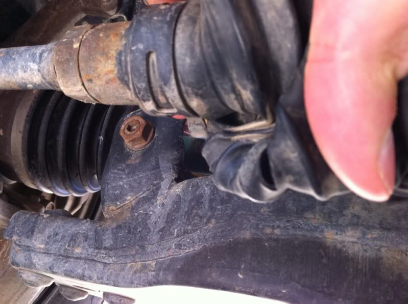

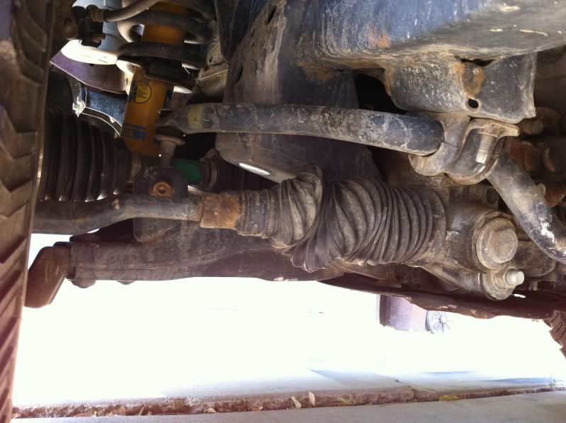

Should I be worried about this?
If so, what is it and what do I do about it? The one in question is my driver's side, the passenger's side is for comparison. For the record, there's nothing leaking from it.
Driver's side:
Hole in the boot:
Passenger's side:

LOL that looks hilarious. can't believe it's not leaking.

Grab your tire at 9 and 3, and wiggle it back and forth. If there's play, there's something bent/broken in the steering rack. Otherwise it could just be a fucked up sleeve/boot which isn't a huge deal.

Guessing a dumbass did your alignment when he was adjusting your toe or it's seized. The boot is supposed to rotate as you adjust.
You can buy just the boot if you want to replace it.

Can you provide a little more insight?
I assume you mean with my tire off the ground, yeah?
Is that my steering rack? Cause I've had it replaced a few times from a shop in town (under warranty for their work).
If that's something they did, I'll bring it back and have them fix it for free

It's not a CV...its a steering rack boot. There's no real grease in there. It's just to protect the rack end from debris.

No, tires on ground. Just grab and wiggle/shake.

Quote:
Thanks jberry. I'll contact the shop and have them fix this for free.

squeeze the little clamp at the end of the boot to loosen it and un-tangle the boot. Done /Thread
Yessir...that's part of the rack.
Tie rod is connected to rack end which is covered by that boot.
The boot is easy to replace, but you'll have to uncrew the tie rod all the way. It's best to just mark it with a paint pen so you don't have to get an alignment after.
I grabbed it, wiggled and shook it. It moves a bit back and forth.
But so does the passenger side.
Here:
http://www.ncttora.com/fsm/2003/Repa...4wdpr/comp.pdf
Thanks again jberry
I'll bring it to the shop and have them do it. If they act like douche canoes, I'll do it myself.

Apparently a retard (sorry PC police) did the alignment on my truck last year.
Brought it back, showed the owner, they're going to replace the inner and outer tie rods, redo the alignment and replace the boot for free.
