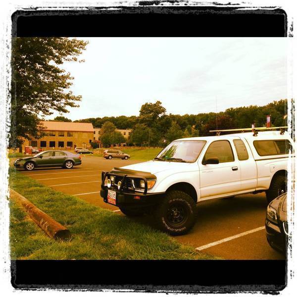

Ohk guys i know there is 10000 threads about lift on here, but someone please give me some advice. i have a 97 Tacomaxtracab 5speed running 31X10 Duratracs on craigers. What wold be a fairly simple Lift, about 3 inches is what i am looking for. cmon guys you are smarter then me! looking to spend 400-600$ on this

You should just do bilstein 5100's front and rear with an AAL in the rear and add eibach springs for the front struts...should be right in your price range.

Eibachs, 5100 set at 0, 5100 rears, and a progressive aal

As with all the other thousands of threads, you really didn't need model specific advice. You basically have a First Gen 4X4 that you want to lift about 3 inches. That is all that is needed. Specific model, wheels, and tires have nothing to do with the lift, as you never mentioned if you were lifting to prevent rubbing, etc. Lifts for the First Gen tacos fit about 99 percent of all First Gen Tacos. If you have read all the threads, then you should have seen the same advice in nearly all the threads. The main thing that would vary would be if you have an aftermarket bumper and winch and would need stiffer springs to counteract its weight.

ok ok ill give that to ya, i do have a ARB Bull Bar on the front, and a trailgear tube bumper on the rear. it does rub just a little turning left so i would like to get rid of that also
