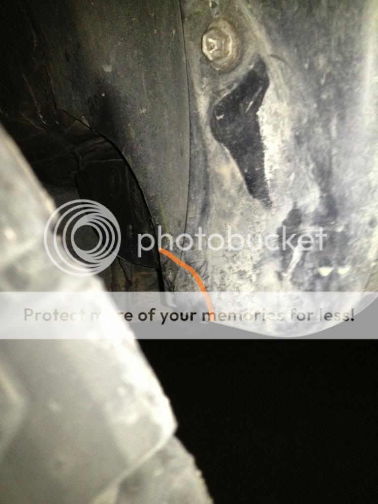

Hey guys, so a couple days ago I got my 285/75/16 Hankook dynapro atm's on my 01 tacoma. We already did the pinch weld mod but still have a rubbing issue in the back side of the front fenders when i go over a bump while turning. I took the bolt out but it still does it. It shows where in the pic where. Ideas on how to clearance that? Does anybody maybe have some pics? Thanks

Where exactly should i cut though? What's behind that area?

Quote:
Nothing that cant be painted black to match the rest of whats in your wheel well.... I got rid of my 285's because I wasn't comfortable with trimming the amount of material I thought needed to be taken out...looking back on it and after reading numerous builds on here since....It's not that big of a deal. Just take and trim the portion that you have marked...start there.

Just flex it out, mark what is hitting and then cut what you marked. Then flex it again and see if its hitting anywhere else. If it is then cut some more. Use a grinder with a cutoff wheel or dremel or whatever you have that'll cut it.

So here what we ended up doing. We ended up just doing a cut in the plastic from the pinch weld mod over. Did it all with a utility knife which is a little hard on the fender flare but you can get through it. The part with the arrow to it was originally a mount for the mud flaps. Its a 90 degree bracket of sorts so we pinched the 90 degree bend together with pliers then with a ball peen hammer flattened it up flush against the wheel well giving more clearance. Then painted everything with rustoleum rust resistant paint. Haven't heard any more rubbing since
