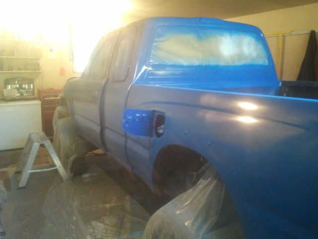

Looks good man!!!

Sweeeeeet!!!

Looking good so far! I like your choice for wheel color but the stock toyota wheels look cheap.

Thanks guys. Yea i know wheels look cheap but i cant afford new ones. it was either new studded dura tracs in 285/75 16's or rims .. i picked tires.

dude, excellent job! Looks amazing!

Looks awesome man!!!

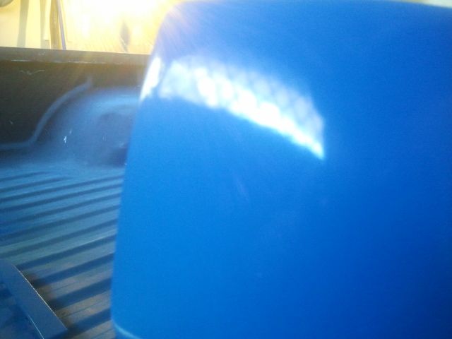

yep it turned out really good. I still am going to color sand and buff this thing in the next few days It isnt perfect,Iv noticed one small run on the edge of a panel and in the doorjam there is a spot where the tape kinda stuck and pulled a peice off. I will get it all fixed up..

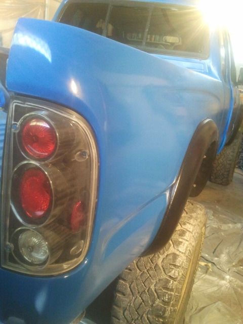

Wow awesome job with the paint! I think it is time for a color change on the rims though

Thanks man. I need a set of rims. Maybe in the spring.

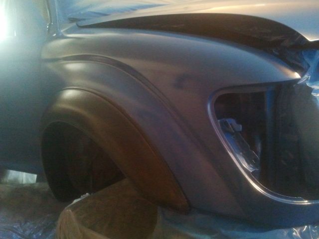

Color sanded with 1200, found a few blemishes. Gotta touch up the bottom of the passenger door.
Once everything is dry i will go over the truck with 1500, then 2000, then hit it with some compounds.
