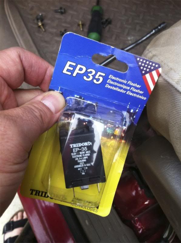

Talking Turn Signal Flasher Relay
After installing my LED turn signals on my front bumper and after a handful of months of listening it run super fast.
I gotten tired of it and looked into slowing it down.
Yes I know about the RELAY modification, but I did not want to go down that route.
So a quick check on the inter-web and I found that there was a relay replacement that will work with LEDs!
Here is my write up.
http://www.ttora.com/forum/showpost....6&postcount=51
$13 and 15 mins later… all done.
Easy cheesy!

Got the exact same one!

Since I recently upgraded mine to LEDs I saw this post this morning and was surprised that the auto zone here had them! Thanks for the write up!

Got mine today! Thank You!!!!
Ordering front LEDs now..
When i called Auto Zone, they advised that tridon is being changed to nouvto??? something like that, Same Part number, same packing..
I got their last one with Tridon on the Flasher..

Sweet! Thanks Tej, now I can ditch my resistors. I thought it was WAY more complicated!!

I just did this last night, perfect. A little faster than stock, but I'm not complaining. Better than those bulky resistors. Thanks a ton!

Worked for me. If you have LEDs as turn signals at all, anywhere on your truck...this EASY mod corrects it.

They'll hyper flash. Two LEDs up front, regular out back, or vice versa...they'll hyper flash. I'm running LEDs up front and regular incandescents in the back, with the flasher relay, they hyper flashed. After the EP35 relay, no hyper flash.
