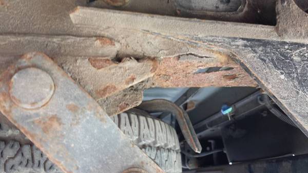

Looks like I have some work to do. At least it's doesn't have to be done in a weekend! I got other rides.
[url=http://www.tacomaworld.com/gallery/showphoto.php/photo/411008/cat/500][/url
Hoping to find time to take the bed off tomorrow. I will post some pics as I go.
Does not look good.
What's the plan?

Doesn't look to bad. Looks like some welding in some reinforcements after prep and removal of the cancer and you'll be good.

Yeah pretty happy really . Truck lived in Va. for entire life. Lucky for me 1st owner afraid of snowy roads. Wish my 95.5 had looked this good.Also found drain holes in rail bottoms clogged. I have pics but won't be able to load till late night because of cell activity.

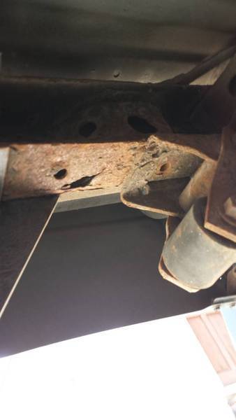

Here's a few pics after chipping,scraping and power washing with blaster tip.

Yeah it's all good. I'm gonna fix it. Only 2 spots need any cutting,grinding,welding. Looking at por 15 or eastwood products. Like the aerosol with tube to get product inside boxed frame section. Gonna do it right! It's parked in my air cond shop. Thanks for the offer Brandon. Later
