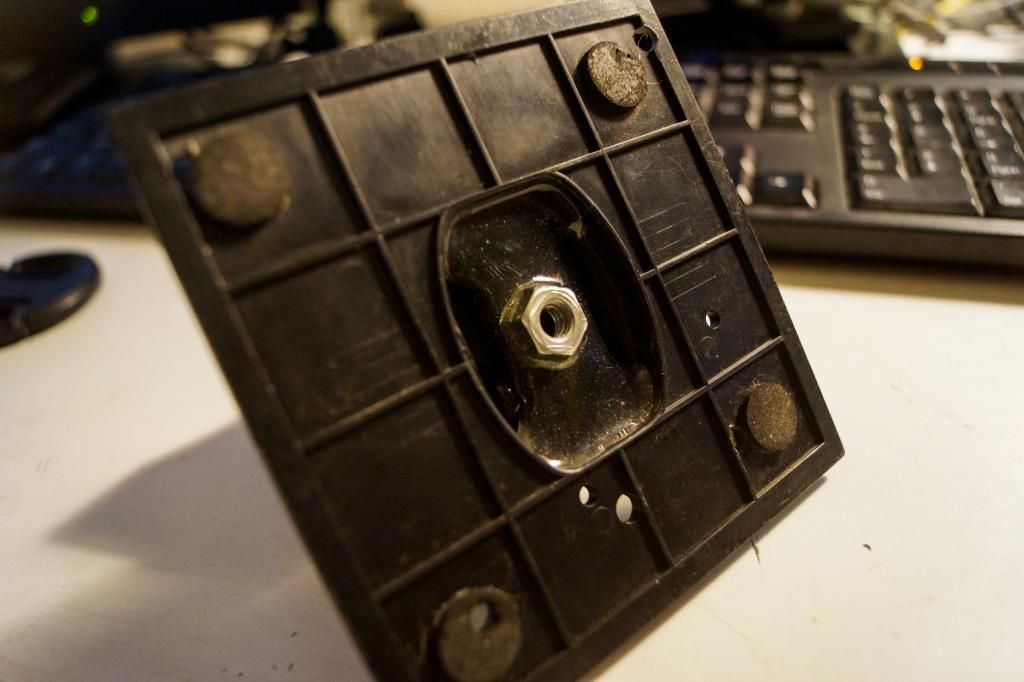

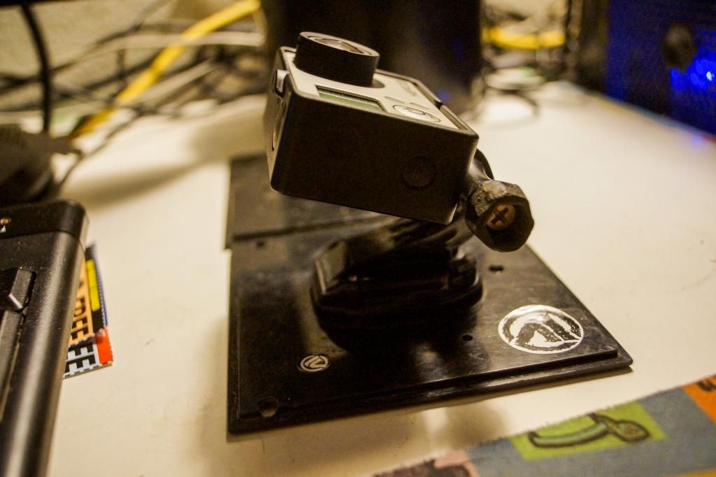

You can use the tripod mount and a bolt to secure the camera in the wheel well. There's a few random holes in the frame to mount to. I've made a DIY tripod mount out the the top plate that comes with the GoPro by epoxying a nut to the bottom, keeps the camera nice and secure to the flat surface.sorry fuzzy pic
