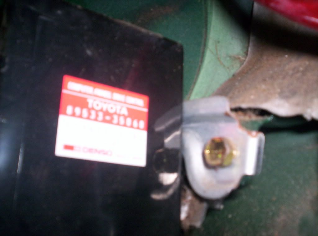

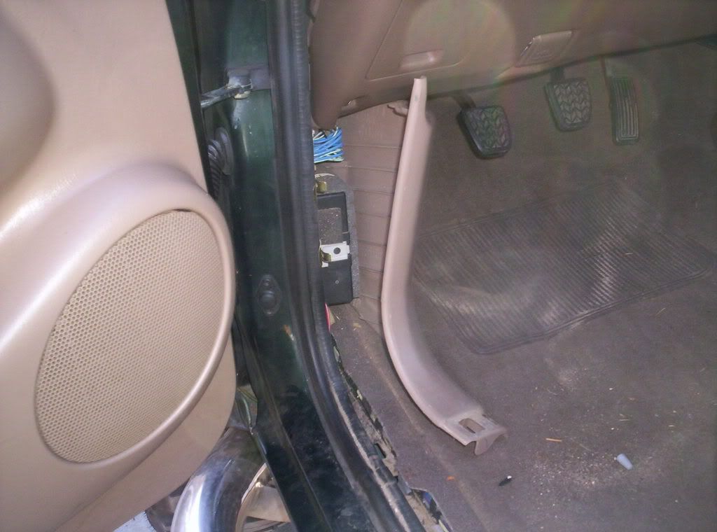

this mod will let me use the locker in 2wd 4hi and 4 lo insted of just 4lo i have a 2003 trd 4x4 it worked on my truck and i am showing you how i did it dont blame me if you screw something up this is the gray wire mod i have seen it on ther sites but i decided to put my truck on the line and try it on my truck sorry for the spelling
start with taking off a couple trim peices 4 screws and a little tug gets them off ![]() ![]() now locate the 4wd computer it stands out ![]()

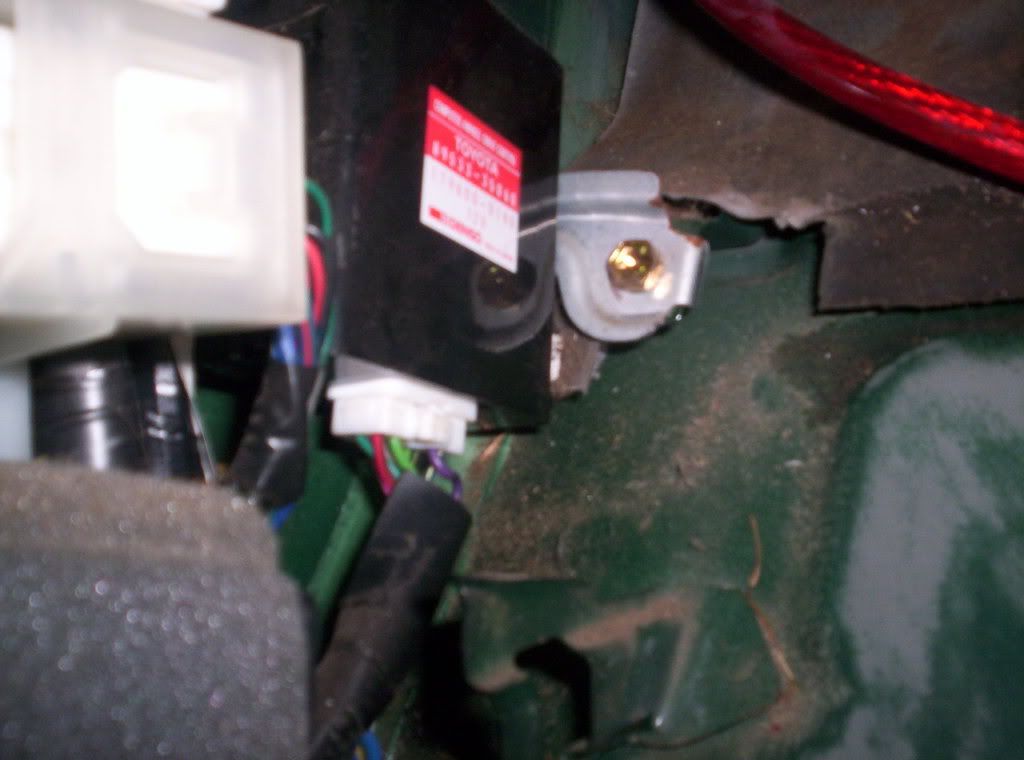

there is a plug in the bottom unplug it and locate the gray wire i have heard on some trucks the color is diff
![]() ![]() now cut the gray wire about 6in from the connector and attach a peice of wire i used some red wire i had attach it to the part coming from the connector and then tape it up to make sure it doesnt come lose also tape the other end of the wire not being used anymore ![]() now i ran the red wire to a ground screw that was already there and thats it test it before you put every thing back together
