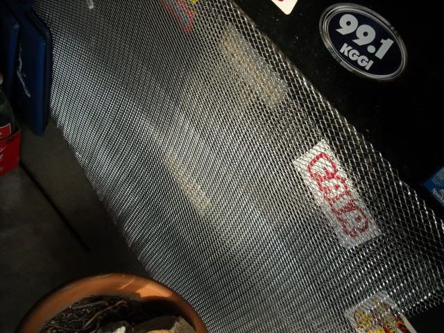

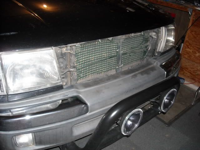

over the past few days i have made a mesh grill for my 00 tacoma i made it like the way a grillcraft is installed but it cost me $180 less than a grillcraft grile so tell me what ya think!

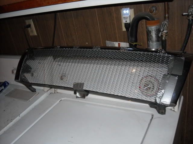

pulled out my grill and this was my makeshift grille for a few days haha
got a 6ft by 3ft mesh for $6.50

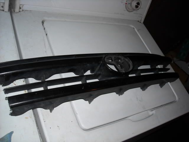

then cut out the center from the surround
sanded out all tabs

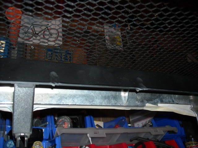

trimmed until perfect fit

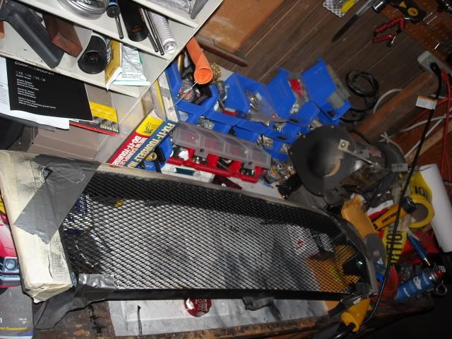

painted
and done!

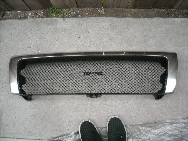

i did mine today but its a little different. looks good man.

nice! man ur hood is nuts!!! good work

looks good man, what did u use to hold the mesh in the grill?

i left mounting tabs that i did 2 screws through on each side and then i used silicone sealant to hold it in from wobbleing

hahahaha that hood is awesome!
