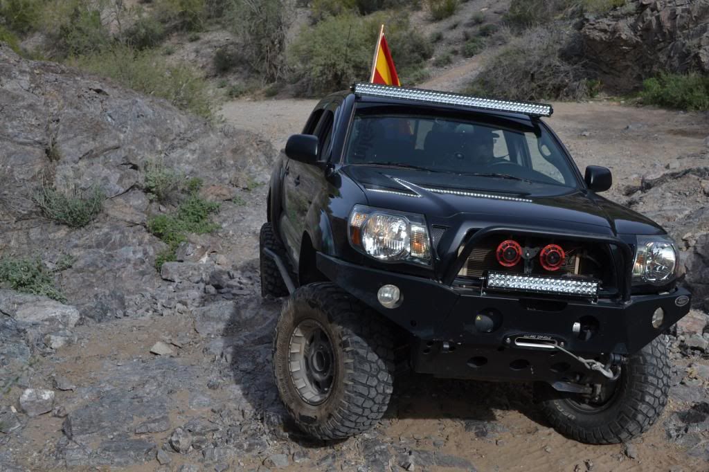

Kyouto42's Build
2010 TRD Off-Road 4x4 Double Cab, Black Sand Pearl: "Gypsy Danger" (Updated November 18th, 2012)
Current setup picture:
Mods Currently Installed -
Interior:
- Wet Okole Seat covers (Charcoal/Black with Black head rests, black/red TRD Off-Road logo, no piping, center console cover, both seats have pockets)
- Weathertech floorliners (black)
- GripGo Universal phone mount (badass)
- Ultragauge
- Lite up 4x4 switch
- Ipod Adapter (control via ipod, but it does charge)
- Plastiderp'd some interior, will do actual black out painting.
Communications:
- Cobra 75 CB
- 3' Firestik Antenna
Armor:
- AllPro front bumper with lightbar and shackles (first generation bumper)
- AllPro IFS skid plate (second generation)
- AllPro transmission skid
- AllPro Rear Bumper + Side skirts (sides still need install)
- AllPro Transfer Case/Exhaust skid
- Avid Off-Road Hybrid DOM Sliders with kickout
- Boztec Rear Diff skid (Powdercoated at AZ Powdercoat)
- Pre-runner style tire gate with full matched spare
Recovery:
- HiLift mounted to a bed bar
- Fire Extinguisher + quick release mount (from SDHQ)
- Shackles mounted to all four points on AllPro bumpers with noise isolators.
- ARB Recovery kit
- ARB VR-8000 Winch
- Harbor Freight (beater) recovery strap
Exterior (anesthetics):
- Rear Diff breather mod (to gas area)
- Debadged
- Chrome grill painted BSP
- In-channel window visors
- Stickers: AllPro on rear window and IFS skid, Tread Lightly sticker on rear window, SDHQ (rear window), Toyoda (rear window), 98KUPD (rear window)
Suspension/Tires:
- Fox 2.5" Remote Resi coil-overs front with 700lb King Springs
- Total Chaos UCA's (stock length)
- Total Chaos Race LCA (stock length)
- Wheeler's Superbumps on front
- Icon Hydro Bumps rear
- Icon 2.5" CDC remote resis on the rear
- AllPro Expedition leaf pack
- AllPro U-Bolt Flip Kit
- ProComp 7089 16" with 4.5" backspace (including spare). TPMS mounted
- BFG KM2's, 285/75/R16 on all 5, black-out
- Shanked wheel locks on all corners
- 930 Bates CV boots (inner)
Performance:
- AFE Pro Dry air filter
- Every oil change: Mobile 1 Synthetic with a K&N oil filter
- TRD Catback
- Doug Thorley long tube headers
- AFE Stage 2 si intake (with Prodry S filter and pre-filter installed)
- URD O2 Simulator
- Stainless steel brake lines
Lighting:
- Morimoto 35w 6000K Projector kit w/ blackout main housing (currently running stock headlamps)
- 35w HID fog light conversion (4.3k color)
- Rear Blitzpro dust lights ( http://blitzpro.com/amber-led-dust-light.html ) (needs to be wired)
- LED license plate lighting (Autozone strips)
- LED replacement backup lights
- 50" Rigid E-Series on roof (all spot, Sierra Expeditions mounts, whistle isolators from Rigid)
- 20" Rigid E-Series on bumper
- Vision-X Amber pods on bumper
Mods to Install/complete (Have on hand):
- ARB Onboard air
- BlueSea fuse box + breaker
- Vision-X Tarantula rock light system
- Underhood LED lighting
- Bedside LED lighting
- Maglite holder
- Satoshi Grill
Mods for future consideration:
- Ham radio setup
- Red coated valve covers (cause I can)
- NST lightweight pullys
- Modify y-pipe to eliminate drop
- Storage setup of some type for recovery gear
- Bed rack with "x brand here" ARB style roof tent. Also want to have fuel/water storage built into it, recovery gear, and such.
- Roof Rack (Toyota) with cage, two remote control HID spotlights
- Strobes (for off road use only on faster back trails). Probably green or something obviously not cop-ish.
- Sound deadening
- Dual batt?
- Under bed storage modification? (Thinking for some basic tools or something, possibly open and lock via the top side of the bed)
- Secondary front shocks (plus upper mount)
Current work needed (more for my notes):
Critical:
- Fluid changes (Transmission, front diff, xfr case)
- Re-torque front bumper and all suspension
- Spindle gussets
- cam tab gussets
Non-critical:
- Steam clean the engine bay
- Fix projector retrofit issue
- Wire aux lights and create switch panel in cab
- Inspect a/c compressor (suspect clutch is failing)
- Re-grease in-cabin pile of crap air blower
- Re-torque exhaust
- Repolish/repair exhaust tip
- Dump exhaust over axle with exhaust tip relocation
- Install 20" E-Series Rigid LED bar
- Install Vision X ambers
- Single Din Radio + Fit Kit + Switches (front amber/rear amber/50"/20"/Rock/bed/usb charging)
- Get missing clip for overhead console
- Noise isolators on 50"
- 3M interior cf wrap for some panels
- Black paint for some trim pieces
- Repaint rear bumper
- Re-powdercoat front bumper
- Rebuild front coilovers... maybe replace with Icon 2.5" r/resi cdc
280Z Build tasks (cause, why not)
To get it running
- New radiator from ArizonaZCar
- New radiator fan/shroud (custom LS1 fan + home made shroud)
- New carb (probably a new 4 barrel)
- Full tune and transmission adjustment
- Full fluids service + rear diff inspection
- Battery charge
- Plugs
- Starter replacement with relay re-location
- Gauges + wiring
- Suspension (new coilovers) Maybe http://thmotorsports.com/tokico/toki.../i-526310.aspx
- Change all bushings to poly (already have kit)
Stuff to add/change
- A/C compressor + plumbing to cabin blower and such
- T-56 6 speed + supporting hardware and custom mounting/driveshaft/ect
- Possible LS1 swap, or RB...
- Fuel cell (maybe)
- Front and rear brace bars
- New wheels and tires and size changes (TBD)
Exterior
- Strip body down, fix all holes/imperfections, repaint
- Find front bumper (240z style bar)
- LED secondary lighting
- Projector retrofit
- Fix rear body panel shave
- Roll fenders and fix ZG flares
- Undercoat car
Interior
- Lizardskin interior metal coating
- Sound system (in the air, I do have infinity reference speakers, maybe android tablet?)
- Crash roll bar + harness mounts
- Aftermarket seats (already purchased)
- Gauges
- Electric door locks and windows
- Tint windows
