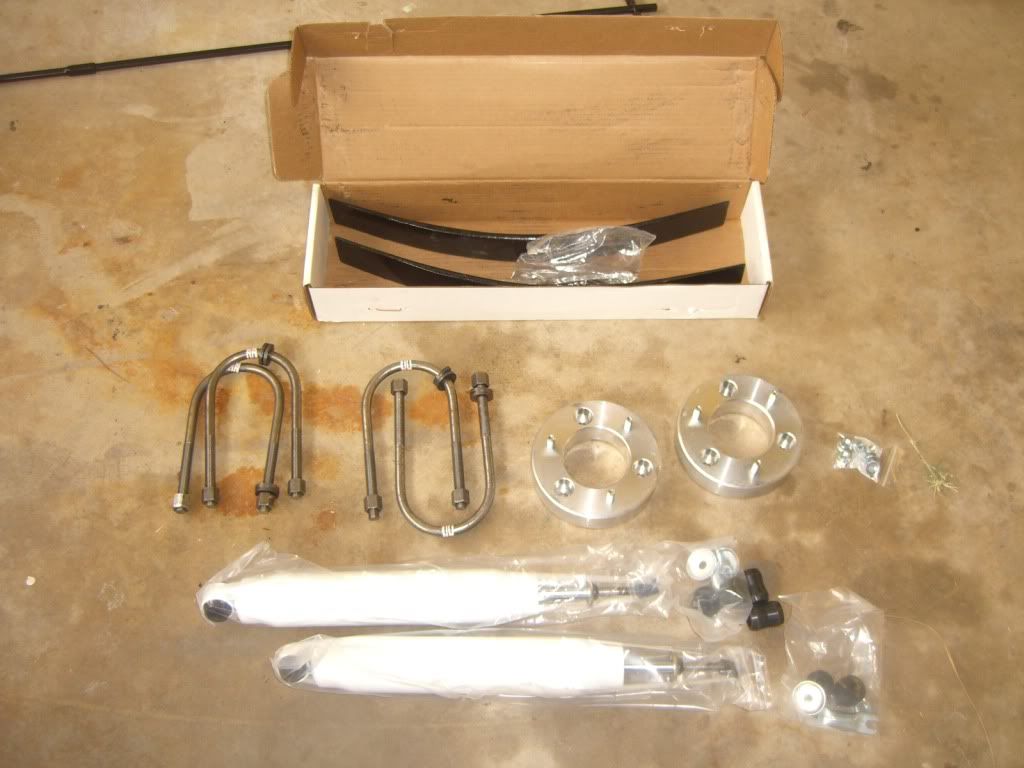

Now was time to lift the truck. There are two lift kits available for the 5lug Taco. The ReadyLift for about $350 shipped and Fat Bob's Garage lift kit for about $250 shipped. I have chosen the Fat Bob's kit, because it is cheaper and comes with longer rear shocks.
Fat Bob's Garage kit. the kit comes with front spacer & nuts for the front spacer, rear add-a-leaf manufactured by AllPro, rear longer shocks & longer U-Bolts with nuts. Kit is high quality and easily installed in your driveway;
Front spacer installed on top of the front strut;
This is how it looks installed back in the truck;
Fat Bob's Garage rear shocks next to stock rear shock;
Add-a-Leaf installed;
Now the truck is lifted and the only thing it needs to complete the outside look are tires. I was planning on keeping the stock tires for a while until they are gone. That was cut short by my offroad trip, when I got back my rear tires were shredded with chunks missing out of them. My spare had a nail in it, so I broke down and bought tires. At first I wanted to get 30x9.5x15. When I was looking at the used tire yards, the only set of 30x9.5x15 were run down BfG's... Next to them I saw nice looking Bridgestone Dueler H/T in 31x10.5x15, they had what seemed to be like 60-70% thread left and the used tire yard wanted $200 for the tires, mounted & balanced, so I pulled the trigger. New tire next to the stock tiny tire;
This is how the truck looks now... Much better than stock right?

Fat Bob's Garage lift kit - $250

Looks Great! I too did the Spacers in front and Rear Add-A-Leaf and put on some 30X9.5X15's and it looks great. They are on stock rims that I painted black. Let me know how the new headers are and how they affect the performance. Im looking into regearing my truck to 4.30 if I can find gears that size... 4-Wheel parts has a place to install and buy parts from near by me and all they have is 4.56. Did you install these gears yet? I know i definitely need them, my mpg's went from a normal 20 average to 18 average and the power feels like junk.
Great looking truck! Where did you find the breather mods for the rear diff? I need to get that as I go offroading alot.
Suggestion to complete the overall look you might want to look into some black headlights they are stock looking but with black inside. Check out my photos and see if you like them.
Stock Rims Painted:
Heres what it looks like with the lift and painted rims:

I haven't installed gears yet and most likely won't be for a while as well as header, I am getting married in April... I wouldn't go higher than 4.10 gears.
For the rear breather I just got the union & breather from Toyota, fuel line & clamps from ACE. The part numbers are; Breather 90930-03136, Union 90404-51026.
I don't want to take the stock lights apart, I am afraid that I won't seal them correctly and I will have condensation issues...
